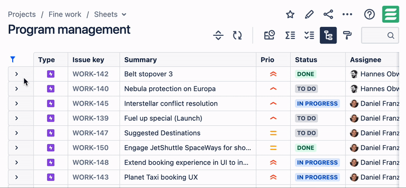

Just to expand on the last point, this is how this would look in the app that my team and I are working on, JXL for Jira. Put simply, you'd pull in the epics of project A, as well as any potential child stories from project A and project B, enable the default hierarchy (that's just one click), and hide any issues that are outside of your hierarchy (that's another 2 clicks):
Once you have your list of issues, you can work on these directly in JXL (much like you'd do in e.g. Excel or Google Sheets), trigger various operations in Jira, or export them for further processing.
Any questions just let me know!
