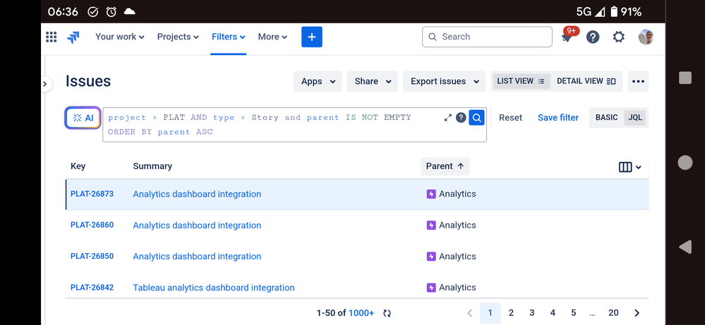

You could start by isolating the Stories that have Epics connected to them -
project = (your project key) AND type = Story and parent IS NOT EMPTY ORDER BY parent ASC
Then, in the search results, I added the parent column so you can sort and start to see, at least visually which and how many Epics are linked to Stories.
Screenshot_20240711-063647.pngThen, you could run the same queries but with Parent in or Parent= to get the list of Stories just for one or a shorter list of Epics.
project = (your project key) AND type = Story and parent IN (epic 1, epic 2, etc)
