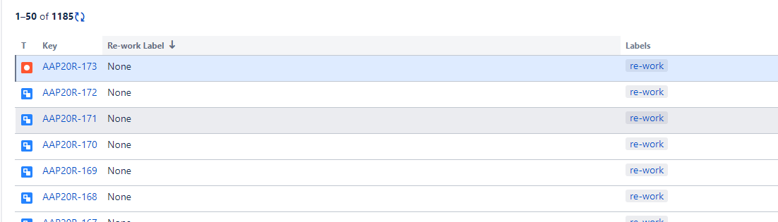

Okay so i have the following JQL:
(category = "Customer Projects" OR category = "Shared - Customer Project Workflow") AND labels = re-work
and it brings back the following results:
What i need to do now is add to the JQL so that it only brings back all those with a 'Re-work label' as Empty (None) as some of these are populated.
If i add AND "Re-work Label" is EMPTY onto the end of the JQL it brings back no results. I have tried different ways of adding that final part into the JQL with no luck.
Does anyone know the correct answer please?

Seems like that's the correct JQL. Is Re-work Label a custom label field? Is that a new field and maybe you haven't reindexed after adding the field to Jira?
What if you turn around the bit to state  "Re-work Label" is NOT EMPTY? Do you get the expected results?

Thank you Christian, Yes it was the lack of the Re-index that caused the problem.
School boy error on my part.
At least i know my JQL is fine :)

if you add
, this probably returns an empty result because the entries all have a "Re-work Label" value - which is "None".
If you tell me what values "Re-work Label" can have and what type the field has (e.g. String, Enum, ...), I'll try to build you JQL query.
However, I am not sure I understand what you want to see exactly:
Do you want to see all issues (in one of the two categories AND label "re-work") that do have a "Re-work Label" value other than "None"?
