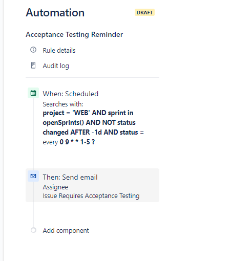

Paul McGrellis
November 9, 2022
@Walter Buggenhout Thanks for that.
It is retrieving the correct issue's but for some reason it is not sending out the added condition email.
I have the above query setup as a WHEN component with the Send email trigger as a THEN component afterwards.
Any ideas how I would so this? Do i need to call the Send Email action within the query somehow? I have to manually click on the Run Rule option to send the email.

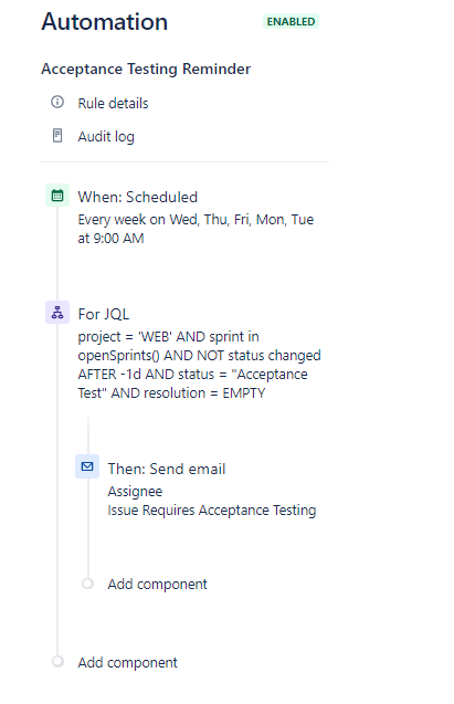

Paul McGrellis
November 9, 2022
@Walter Buggenhout Think I was doing it wrong.
Does this look any better?
