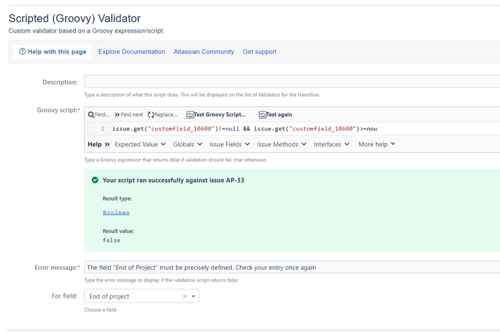

If you wanna do this with JMWE, you can easily implement it with Scripted (Groovy) Validator. Once you have added the validator set its parameters as followed:
Groovy script:
issue.get("customfield_10600")!=null && issue.get("customfield_10600")>=now
Error message:
The field "End of Project" must be precisely defined. Check your entry once again
For field:
End of project
Note: it is recommended to use custom field IDs instead of names because upon changing field names you will have to change your validator but by using IDs you won't have to.
Hope it helps.

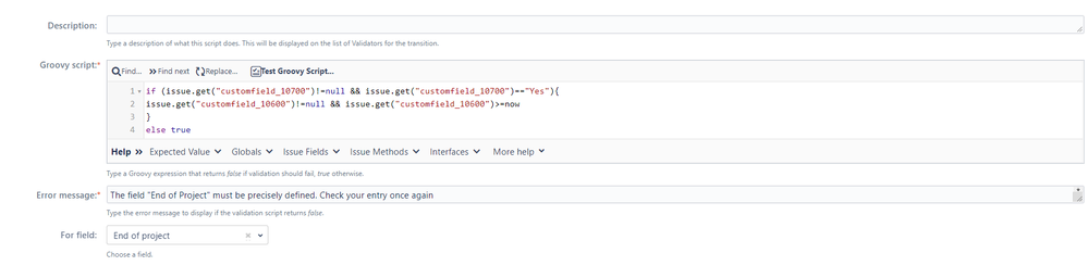

You can use the following code for your use case:
if (issue.get("customfield_10700")!=null && issue.get("customfield_10700")=="Yes"){
else true
 customfield_10700 is the ID of fixtermin field and customfield_10600 is the ID of End of Project field.
You can also use the following code which does the same thing but just in one line:
issue.get("customfield_10700")!=null && issue.get("customfield_10700")=="Yes"? issue.get("customfield_10600")!=null && issue.get("customfield_10600")>=now : true
Hope it helps and let us know how it goes.
