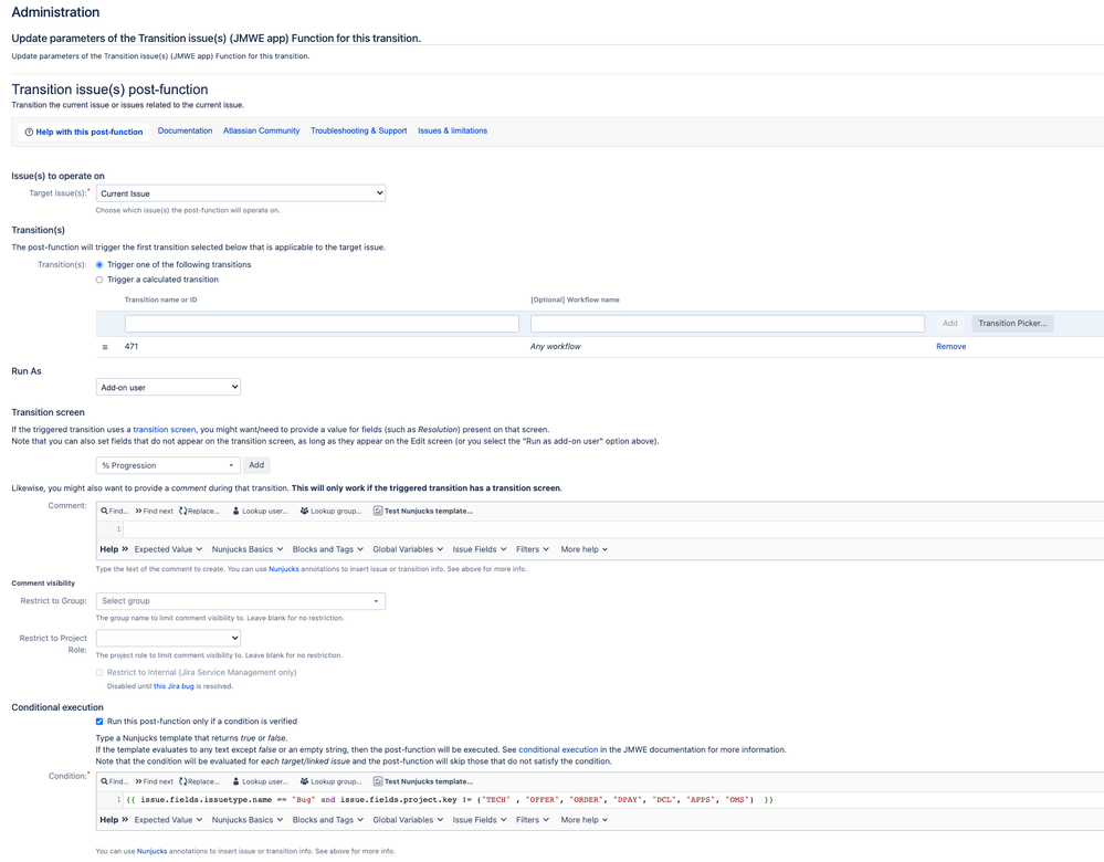

Here is a screenshot of the post-function (with my try)
I tried to create a ticket inside "ORDER" and the ticket transition automatically to In Progress.
I'm kind of lost here
Joseph Hani
July 28, 2023
Well ... It seems that I have forget to add "[]" ... I test again, correcting my mistake and now it's working perfectly !
