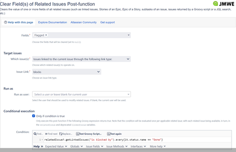

You have placed the "Clear field of related issues" post-function on the "Done" transition of the workflow issue A and C follow. When you trigger the transition "Done" on A or C, you want the Flagged field to be cleared on C only when A and C are in "Done" statys. To achieve this using JMWE:
  1. Add the Clear field of related issue post-function to the transition
  2. Select the Flagged field
  3. Select the link type
  4. In the condition execution, input this script
  5. relatedIssue?.getLinkedIssues("is blocked by").every{it.status.name == "Done"}
  6. Save the post-function
  7. Place this post-function to the end of the list
  8. Publish the workflow
Your configuration will look something like this:
relatedIssue here points to the issue C automatically. So you need to find issues linked to C through "is blocked by" link type and then check that they are in the status "Done".
