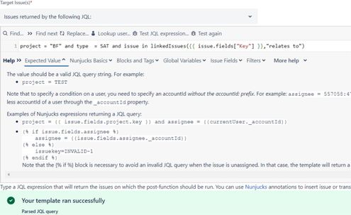

I'm trying to create a post-function by using set issue fields option.
I have to reach fields of linkedissues of current issue.
I have successfully tested jql like below

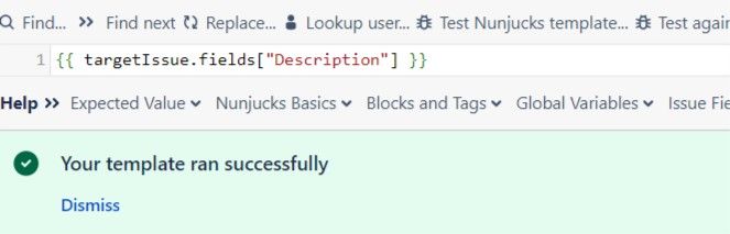

But I cant reach a field of targetIssues. I have tried this
Although description of target issue is not empty, I cant see the result.
Could anyone help?
Thanks,
Aslihan
Aslıhan Paksoy
November 5, 2021
Actually I have solved it :D I had to use dump filter.
{{targetIssue.fields["Total Budget"] | dump }}
