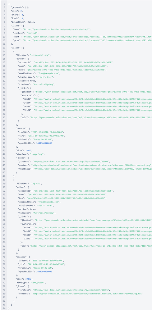

{ "_expands": [], "size": 2, "start": 2, "limit": 2, "isLastPage": false, "_links": { "base": "https://your-domain.atlassian.net/rest/servicedeskapi", "context": "context", "next": "https://your-domain.atlassian.net/rest/servicedeskapi/request/IT-15/comment/1001/attachment?start=4&limit=2", "prev": "https://your-domain.atlassian.net/rest/servicedeskapi/request/IT-15/comment/1001/attachment?start=0&limit=2" }, "values": [ { "filename": "screenshot.png", "author": { "accountId": "qm:a713c8ea-1075-4e30-9d96-891a7d181739:5ad6d3581db05e2a66fa80b", "name": "qm:a713c8ea-1075-4e30-9d96-891a7d181739:5ad6d3581db05e2a66fa80b", "key": "qm:a713c8ea-1075-4e30-9d96-891a7d181739:5ad6d3581db05e2a66fa80b", "emailAddress": "fred@example.com", "displayName": "Fred F. User", "active": true, "timeZone": "Australia/Sydney", "_links": { "jiraRest": "https://your-domain.atlassian.net/rest/api/2/user?username=qm:a713c8ea-1075-4e30-9d96-891a7d181739:5ad6d3581db05e2a66fa80b", "avatarUrls": { "48x48": "https://avatar-cdn.atlassian.com/9bc3b5bcb0db050c6d7660b28a5b86c9?s=48&d=https%3A%2F%2Fsecure.gravatar.com%2Favatar%2F9bc3b5bcb0db050c6d7660b28a5b86c9%3Fd%3Dmm%26s%3D48%26noRedirect%3Dtrue", "24x24": "https://avatar-cdn.atlassian.com/9bc3b5bcb0db050c6d7660b28a5b86c9?s=24&d=https%3A%2F%2Fsecure.gravatar.com%2Favatar%2F9bc3b5bcb0db050c6d7660b28a5b86c9%3Fd%3Dmm%26s%3D24%26noRedirect%3Dtrue", "16x16": "https://avatar-cdn.atlassian.com/9bc3b5bcb0db050c6d7660b28a5b86c9?s=16&d=https%3A%2F%2Fsecure.gravatar.com%2Favatar%2F9bc3b5bcb0db050c6d7660b28a5b86c9%3Fd%3Dmm%26s%3D16%26noRedirect%3Dtrue", "32x32": "https://avatar-cdn.atlassian.com/9bc3b5bcb0db050c6d7660b28a5b86c9?s=32&d=https%3A%2F%2Fsecure.gravatar.com%2Favatar%2F9bc3b5bcb0db050c6d7660b28a5b86c9%3Fd%3Dmm%26s%3D32%26noRedirect%3Dtrue" }, "self": "https://your-domain.atlassian.net/rest/api/2/user?username=qm:a713c8ea-1075-4e30-9d96-891a7d181739:5ad6d3581db05e2a66fa80b" } }, "created": { "iso8601": "2015-10-09T10:22:00+0700", "jira": "2015-10-09T10:22:00.000+0700", "friendly": "Today 10:22 AM", "epochMillis": 1444360920000 }, "size": 23123, "mimeType": "image/png", "_links": { "jiraRest": "https://your-domain.atlassian.net/rest/api/2/attachment/10000", "content": "https://your-domain.atlassian.net/servicedesk/customershim/secure/attachment/10000/screenshot.png", "thumbnail": "https://your-domain.atlassian.net/servicedesk/customershim/secure/thumbnail/10000/_thumb_10000.png" } }, { "filename": "log.txt", "author": { "accountId": "qm:a713c8ea-1075-4e30-9d96-891a7d181739:5ad6d3581db05e2a66fa80b", "name": "qm:a713c8ea-1075-4e30-9d96-891a7d181739:5ad6d3581db05e2a66fa80b", "key": "qm:a713c8ea-1075-4e30-9d96-891a7d181739:5ad6d3581db05e2a66fa80b", "emailAddress": "fred@example.com", "displayName": "Fred F. User", "active": true, "timeZone": "Australia/Sydney", "_links": { "jiraRest": "https://your-domain.atlassian.net/rest/api/2/user?username=qm:a713c8ea-1075-4e30-9d96-891a7d181739:5ad6d3581db05e2a66fa80b", "avatarUrls": { "48x48": "https://avatar-cdn.atlassian.com/9bc3b5bcb0db050c6d7660b28a5b86c9?s=48&d=https%3A%2F%2Fsecure.gravatar.com%2Favatar%2F9bc3b5bcb0db050c6d7660b28a5b86c9%3Fd%3Dmm%26s%3D48%26noRedirect%3Dtrue", "24x24": "https://avatar-cdn.atlassian.com/9bc3b5bcb0db050c6d7660b28a5b86c9?s=24&d=https%3A%2F%2Fsecure.gravatar.com%2Favatar%2F9bc3b5bcb0db050c6d7660b28a5b86c9%3Fd%3Dmm%26s%3D24%26noRedirect%3Dtrue", "16x16": "https://avatar-cdn.atlassian.com/9bc3b5bcb0db050c6d7660b28a5b86c9?s=16&d=https%3A%2F%2Fsecure.gravatar.com%2Favatar%2F9bc3b5bcb0db050c6d7660b28a5b86c9%3Fd%3Dmm%26s%3D16%26noRedirect%3Dtrue", "32x32": "https://avatar-cdn.atlassian.com/9bc3b5bcb0db050c6d7660b28a5b86c9?s=32&d=https%3A%2F%2Fsecure.gravatar.com%2Favatar%2F9bc3b5bcb0db050c6d7660b28a5b86c9%3Fd%3Dmm%26s%3D32%26noRedirect%3Dtrue" }, "self": "https://your-domain.atlassian.net/rest/api/2/user?username=qm:a713c8ea-1075-4e30-9d96-891a7d181739:5ad6d3581db05e2a66fa80b" } }, "created": { "iso8601": "2015-10-09T10:22:00+0700", "jira": "2015-10-09T10:22:00.000+0700", "friendly": "Today 10:22 AM", "epochMillis": 1444360920000 }, "size": 32132, "mimeType": "text/plain", "_links": { "jiraRest": "https://your-domain.atlassian.net/rest/api/2/attachment/10001", "content": "https://your-domain.atlassian.net/servicedesk/customershim/secure/attachment/10001/log.txt" } } ] }
How can I set as variable and extract from above object the value of field links and attribute content on the end of that object?

I've made a request to Jira Service Management Cloud API for Get attachments for request -> https://developer.atlassian.com/cloud/jira/service-desk/rest/api-group-request/#api-rest-servicedeskapi-request-issueidorkey-attachment-get
JSON response is as following (Atlassian example):
(I couldn't paste .txt version)
How can I set as variable and extract from above object the value of field links and attribute content from the end of that object?
So, when you call the Jira REST API using callJira, the result is actually that JavaScript structure you posted. Therefore, you can manipulate it like a JavaScript object.
In your case, the only problem is: what do you want to do if there's more than one attachment? As you can see, the response is an array of objects, one per attachment...
Assuming you only want the first attachment, you could do something like:
{% set result = "HTTP://rest.api" | callJira(...) %}
{{ result.values[0]._links.content }}
