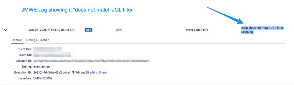

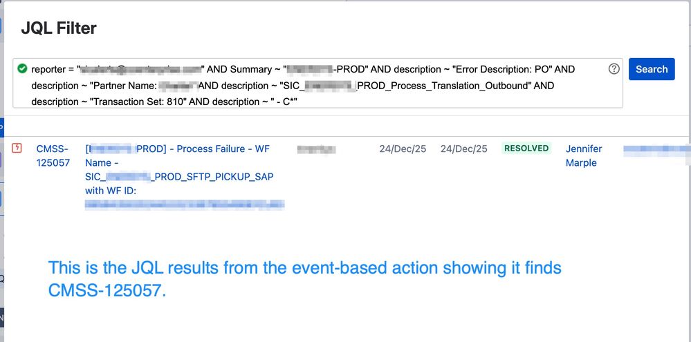

When I am editing the event-based action, the JQL accurately finds the issues that I'd expect it to, but when it's enabled and running, it doesn't, the logs say that the criteria weren't matched.

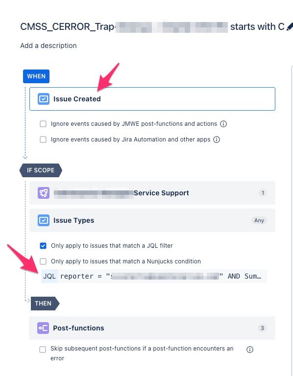

Trudy Claspill
December 26, 2025
Hello @Jennifer Marple
What is the Event you are using in your Event based action?
Can you show us screen images of the details of the Event Based action? I'm not clear where exactly in that action you are using the JQL.

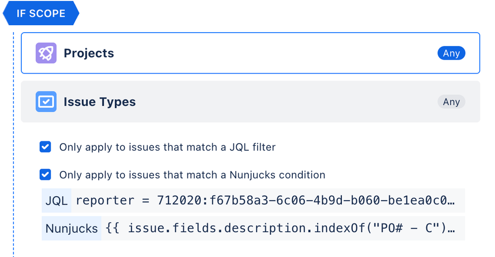

Jennifer Marple
December 26, 2025
Screenshots showing the error occurring:
