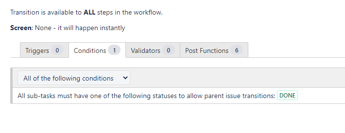

My simple suggestion (with only the information from your original post) would be to create a subtask for each approver and set a condition in the workflow that blocks the transition until all those subtasks are done (condition is called "Sub-task blocking condition") --> see screenshot.

Stefan Salzl
January 28, 2023
Hi @Ajay Taneja ,
1) those are 2 different applications, Jira Software and Jira Service Management. At jira service management this is part of the workflow functionality. In Jira Software (as far as I know) it‘s not.
2) No. This solution would be (as suggested) the most simple way to fullfill the requirement. The subtask for each approver would need to be created manually in this case.

Stefan Salzl
January 28, 2023
Hi @Ajay Taneja
1) The approval function is a service management feature so this can (as far as I know) not be integrated in Jira Software like in Service Management.
2)
a) correct
b) no not for every Story. A workflow is something that is associated to a issue type (like story) so it is the same for every story.
c) exactly. You need admin permission to edit workflows.

Stefan Salzl
January 29, 2023
@Ajay Taneja
In generell the condition is checking for subtasks and specific status (eg. every subtask needs to have status "Done" in order to do the transition of the story). If there is no subtask (like approval subtask) the transition can be done immediately. So no need for another workflow.
Furthermore: 1 issue type can´t have several workflows. So you would need to specify two different issue types (eg. Story with approval, Story without approval) and create a specific workflow for each one. (which I guess is not necessary).
Hope this explanation makes sense.
Best
Stefan
