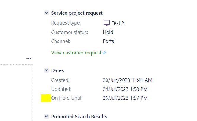

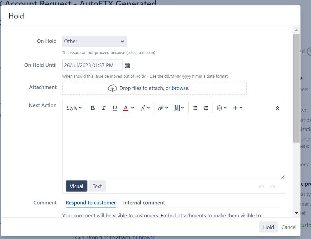

We currently can put a Jira ticket on “Hold” status and enter a “On Hold Until” date (see screenshots). The ticket remains on “Hold” status even after the “On Hold Until" date has expired. We would like to 'automate' for such tickets to change to “in Progress" status after the “On Hold Until" date has expired.  How can I leverage 'Automation' in JIRA to satisfy this requirement?

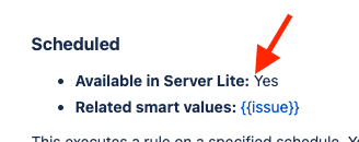

Make note when you are looking at the components that each one will note if it is supported for Automation for Server Lite.
Not all Automation functionality is supported on Jira Server. Some is available only on Jira Data Center.

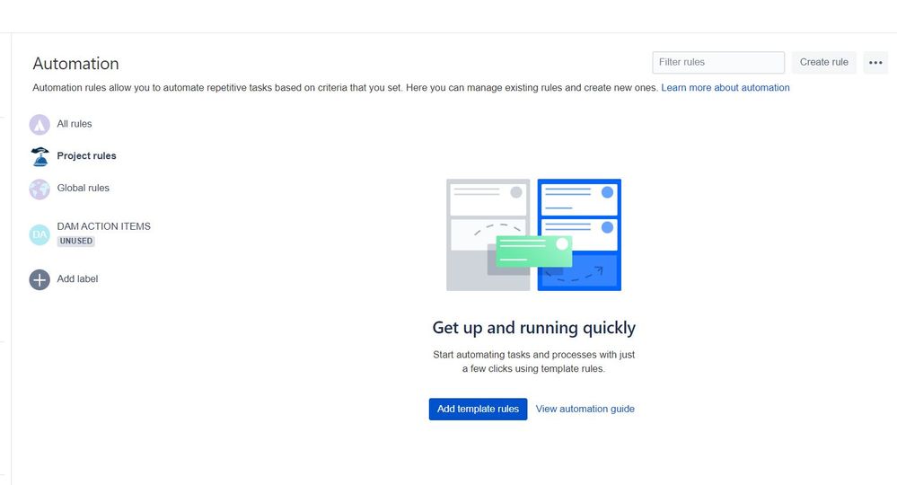

Sorry, I forgot to include the screenshots.  I'm not sure if this is this is the "Jira Lite' app. Hopefully the screenshot gives you an idea of what 'automation' option is installed.

That does look like the Automation for Jira product.
I can't tell from the screens if it is the Lite product or not, but if you are on Jira Server and not Jira Data Center then it is the Lite product.

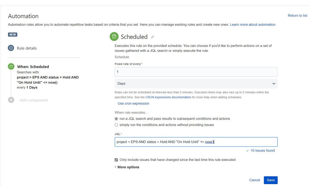

@Trudy Claspill , below is the JQL I came up with. What am I missing?  Thanks
project = XXXX AND status = Hold AND "On Hold Until" <= now(jira scheduled screenshot.JPG

That JQL will work.
Are the issues allowed to remain in Hold until the end of the specified date or only until the beginning of the specified date? If they should come off Hold at the start of the specified date then I would use endOfDay() rather than now().

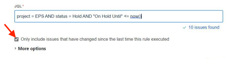

Also, uncheck this box:
