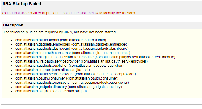

JIRA startup failed: You cannot access JIRA at present. Look at the table to see the reasons
Archana
April 18, 2018
I hvae tried so many ways ..but didnot get solution. Can anyone please help in accessing JIRA?                 ThanksCapture111.PNG
Francesc Arbó
April 18, 2018
Hi @Archana,
According to the image there's a plugin causing the error but it would be better to show the whole error message to understand better this problem.

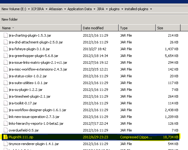

Try to move all files from ...\Atlassian\Application Data\JIRA\plugins\installed-plugins and then start Jira. If it loads ok, at least one of these files is the origin of the error (maybe the plugin89.111.zip file).

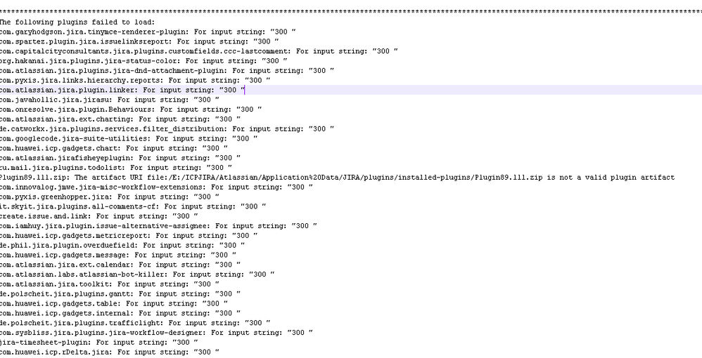

Archana
April 18, 2018
Hi @Francesc Arbó
I am getting plugin issue as i can see plugin89.111.zip file is loading in Zip format
2018-04-19 13:00:59,150 main ERROR [atlassian.plugin.loaders.ScanningPluginLoader] Unable to deploy plugin 'com.javahollic.jira.jirasu', file Unit: E:\ICPJIRA\Atlassian\Application Data\JIRA\plugins\installed-plugins\jira-su-plugin-1.2.2.jar (1326684548000)
java.lang.NumberFormatException: For input string: "300 "

Francesc Arbó
April 18, 2018
Hi @Archana,
have you tried to start Jira without add-ons in this folder? Now it shows an error in this file: Unable to deploy plugin 'com.javahollic.jira.jirasu', file Unit: E:\ICPJIRA\Atlassian\Application Data\JIRA\plugins\installed-plugins\jira-su-plugin-1.2.2.jar
Archana
April 19, 2018
Hi @Francesc Arbó
I have removed insatlled-plugins and restarted the service. Again it is showing unable to load Plugins error.

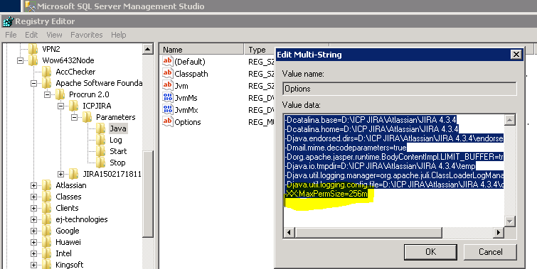

Archana
April 20, 2018
Hi @Francesc Arbó
Issue has been resolved, by adding -XX:MaxPermSize=256m in regedit.exe
Capture@.PNGThanks a lot for the support :)
