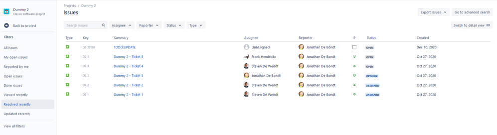

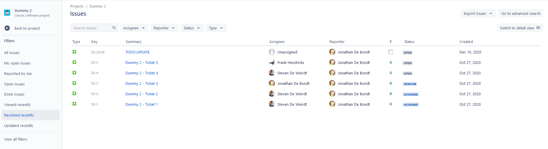

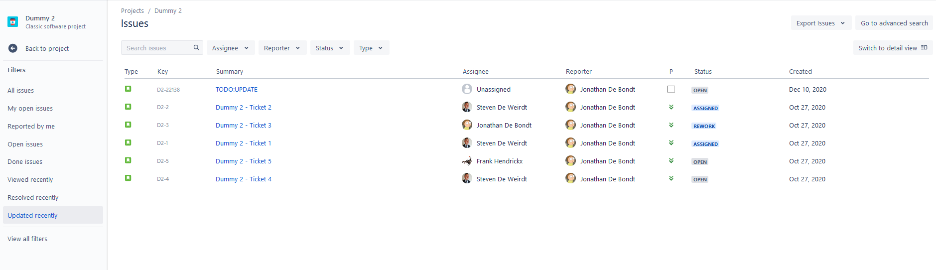

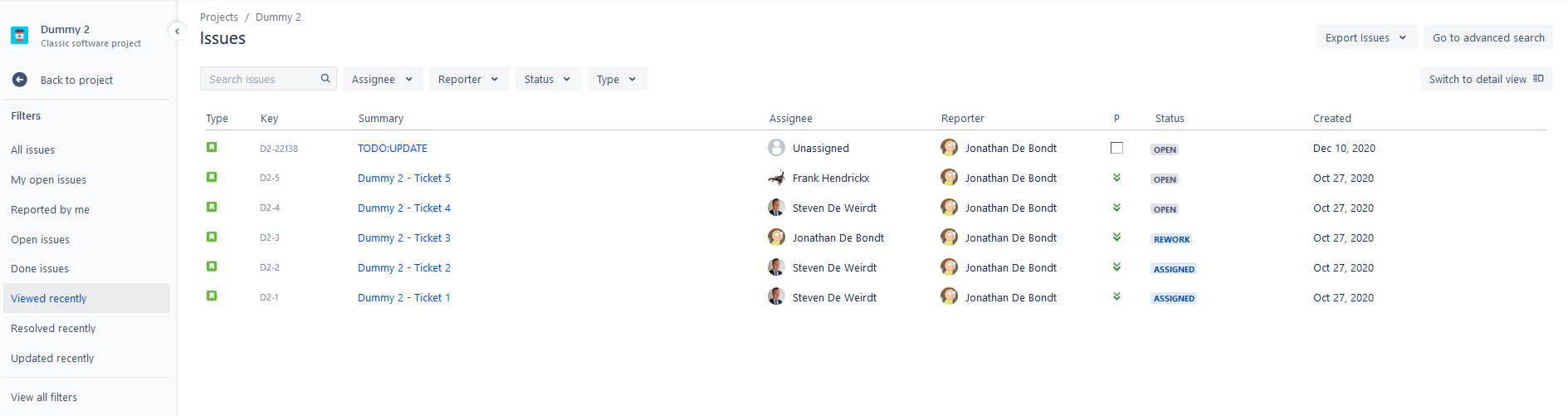

I found that the recently updated/resolved/view filter from the projects standard issue filters do not filter the results correctly when performing the search from the "issue" section from a given project.

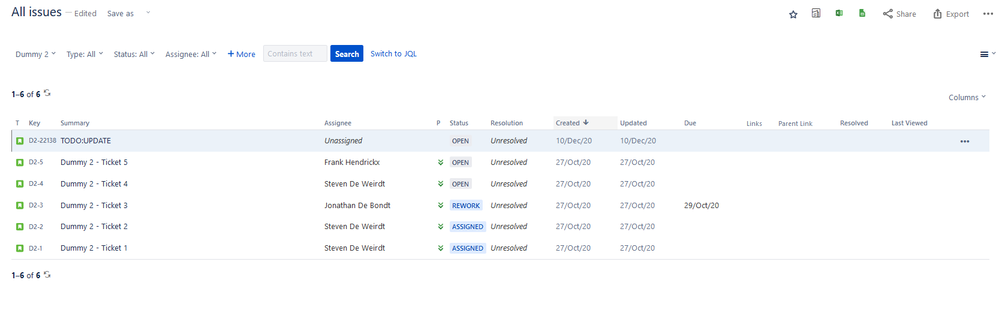

I have attached a few snippet from a demo project i created that shows the results of the 3 filters. All filters filter out the same data even though they do not meet the criteria of the filter.
None are resolved
None have been updated recently
None have been viewed recently
JIRA standard filters - Recently viewed.PNGJIRA standard filters - Recently updated.PNGJIRA standard filters - Recently resolved.PNG

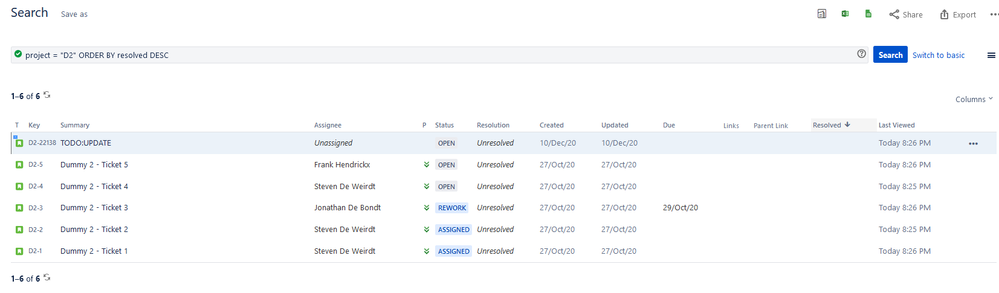

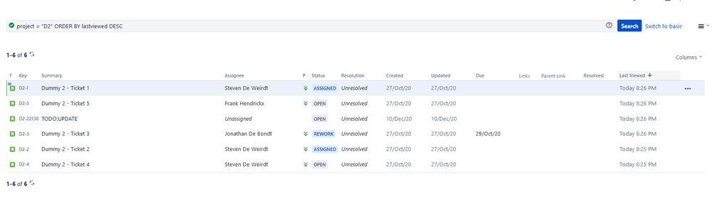

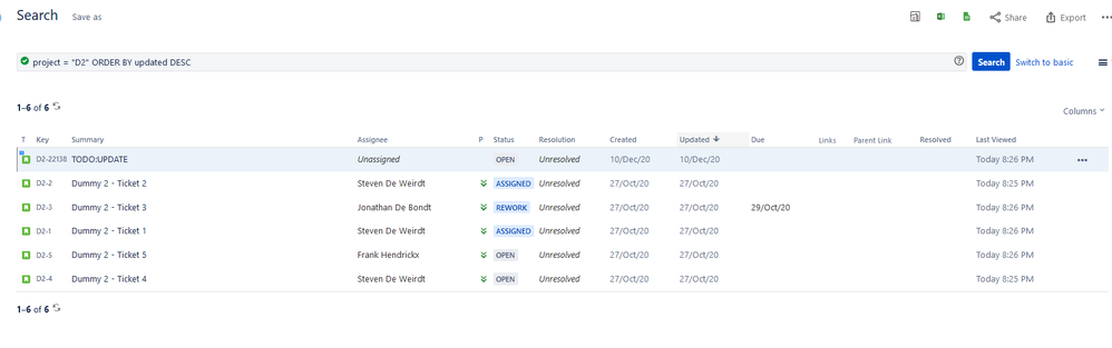

It seems like the filters are just sorting the issues by resolved/viewed and updated times for some reason. As the JQL query isn't shown from the issue section i received the results in the attached snippets by selecting the filter from the project's issue section and then pressing "go to advanced search" button in the upper right corner.
The project does not use any automation but i checked the history of all tickets to make sure and did not see any automation records as such.
JIRA standard filters - Updated.PNGJIRA standard filters - Resolved.PNGJIRA standard filters - LastViewed.PNG

Wow, this came unexpected. Let's focus on the first screenshot. There is clearly missing the restriction as to the usual "one week looking back" period of time.
Or, in other words, Jira behaves correctly - as there is no time selection in the query.
I have never seen such. How come this part of the query is missing?
Now for the second screenshot. Clearly, also the time selection in the query is missing.
We don't need to look further because that way it won't work any different way - formally Jira gives back what the user requests.
Could you please raise this with Atlassian support?
I have never encountered something else than:
Created recently = created >= -1w order by created DESC
Resolved recently = resolutiondate >= -1w order by updated DESC
Updated recently = updated >= -1w order by updated DESC
Viewed recently = issuekey in issueHistory() order by lastViewed DESC
Please update us on the results!
