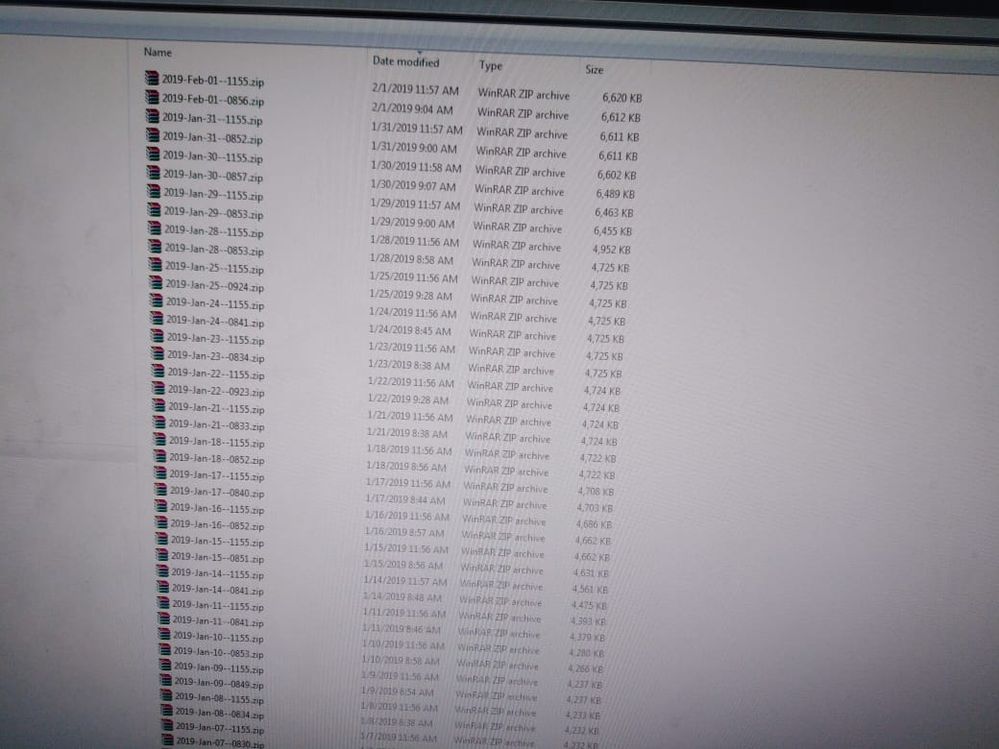

Our JIRA server is configured to take auto backups after every 3 hours. It saves the files to disc as .ZIP files as you can see in attached screenshot. It so happened today afternoon that we wanted our JIRA application to revert to this morning's version zip file. So, what we did is:
1. We went to Settings->Restore and specified today morning's zip file as you can see in the attached image.
2. After pressing the Restore button, it started processing and then gave an error.
Now, the status is that JIRA is not accepting any username/password and we are not able to login. This is very critical as our projects are totally dependent on the projects we have configured in JIRA.
I want to know why it is not logging in with our JIRA users anymore? If it is not possible to resolve this, can we anyhow restore from any of these zip files? This is critical, so please suggest. We'll be in great loss if we won't be able to restore from these backup files.
Note: Our server is not connected to internet and we can not give you any access to it. If required, we can provide a backup ZIP file for your consideration.
