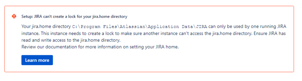

I for the life of me can't figure out what is happening here.  I manually copied the wire Home and Application directory from one server to another.  I also properly pointed to the correct database.  But I am suddenly getting this error message.  This is a first, as I have done this successfully in the past with different servers.  Please advise if you can.  This is running on Windows server 2016.

Hello!
Please, have a look at the similar question.
Tek On Call
December 4, 2018
Thank you.  Quick question.  What would the name of the lock file be in Jira home directory?  Would there be a particular extension.
Johan Soetens _Dumblefy_
December 4, 2018
Name of the file should be .jira-home.lock
Tek On Call
December 4, 2018
Thank you.
Tek On Call
December 4, 2018
I don't see it, So I'm guessing that it's a permissions issue, however I am logged in as the administrator and have full read/write permissions to the drive and or directory.
Grigory Salnikov
December 4, 2018
The file may be hidden. Check "Show hidden files" checkbox.
Tek On Call
December 5, 2018
Thank you very much!  This worked!
