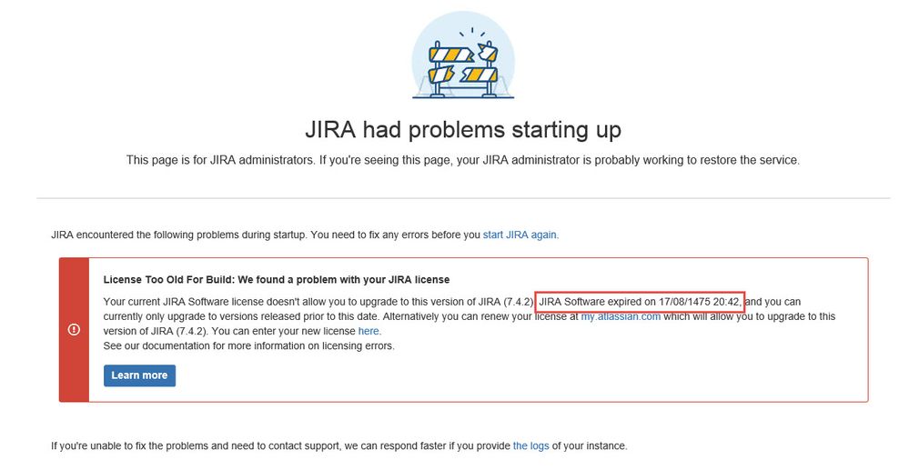

I have problem about transfer license to new server (The old server crash).
I have setup JIRA on new server and after I'm import existing data.
I have got this picture below. That tell "JIRA Software expires on 17/08/1475".
Can anyone help me?

I have seen this kind of error before with another user that had the system regional locale set to Thailand.  I suspect that there might be a different calendar on systems with that local region which might be why the license believes it has expired.
Perhaps you can get around this problem by changing the calendar on the operating system to a Julian calendar.   Could you let me know what OS you are using, and perhaps I can help find more information on the specifics of how to do that depending on your operating system.

So, I also had to do some learning about this too.  I'd recommend the wiki page on Date and time notation in Thailand just for some background on the differences.   Since it appears that the license thinks the year is 1475, I think this coincides with the 543 year offset between the Buddhist calendar and the Gregorian calendar (I thought it was Julian, but technically it's Gregorian).   Which means the 1475 + 543 = 2018.
In which case I think your license is actual still valid (at least until 17th day of August), but because the operating system seems to be using this different calendar of year, I don't believe that Jira is correctly identifying this difference.

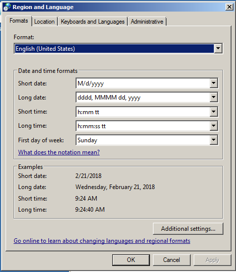

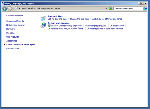

You will need to navigate to the Control panel in windows.  The screenshot below is one way this looks in 2008 instance.  I realize the view might look different in 2012, but basically, I think we will need to change the Region settings of this machine, at least temporarily.
From there, try to change the "Format" to a different selection, such as English (United States).   I am expecting this to change the Windows operating system region settings to use the Gregorian calendar.  After to change this setting, click Ok, and then I would recommend restarting the Operating system.

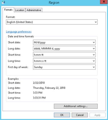

Amnat Prasert
February 22, 2018
I have to check regional setting on my server that get same your setting.
And I have to set location from Thailand to United State. Will retry to setup JIRA again.
