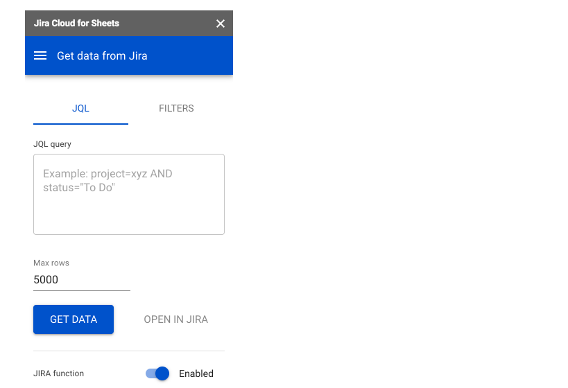

I am using Jira addin for google sheets - https://support.atlassian.com/jira-work-management/docs/use-jira-cloud-for-sheets/
This allows to query jira using Google sheet function JIRA. We can enter on google sheet cell
=JIRA("project = ProjA order by createdDate desc", "issuekey,status.id,another column", 0, 10)
for this function I am not able to query on sprint field. However same query works for Google sheet add-in if I give it in below UIjiracloudforsheets.png
component is not EMPTY AND Sprint in ("Spring'21 Sprint1") AND status was in (Closed, Done) during ("2021-01-25 11:45", "2021-02-07 00:30")
