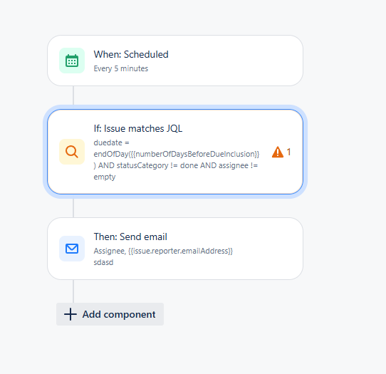

Hi experts,
I am new to jira automation here. I am testing a automation to schedule send an email notification to reporter after 3 days the issue is due, But i am unable to figure out which IF condition to use or to use a JQL to test out the schedule trigger if it works. Appreciate your reply and thanks in advance.
I have checked the forum posts on a similiar issue using JQL: due < 3d and due > now() but having issues as well

Hi @jasonwongys and welcome to the Community!
First of all, you can add your JQL statement directly to a field in your scheduled trigger. You would not need to add an additional IF condition anymore.
Try a JQL like this:
due >= now() and due < 3d and statusCategory != Done and Assignee IS NOT empty
I would also strongly recommend a couple of additional tweaks:
  • add a label to the issues you send a notification for to indicate reminders have been sent and exclude the labeled issues from your filter. Otherwise, you risk sending out notification emails for them every five minutes for 3 days on end.
  • ask yourself it is really necessary to send out reminders every 5 minutes. Unless this is a setting you currently use for testing your rule, this may have an impact on the maximum number of rule executions your Jira plan supports.
Hope this helps!

Thanks Walter, the JQL works. While testing, i changed the JQL to assignee = "{myidname}" just to test the schedule function, i clicked run rules and when i checked my audit log it shows, NO ACTIONS PERFORMED. The assignee is myself
May i know the reason why even though the JQL matches the condition?

February 18, 2025
Hi @jasonwongys
The JQL that @Walter Buggenhout suggested should do what you want, and although you could take his advice on including the JQL in the scheduled trigger I would suggest keeping it as a separate IF statement (at least while you are testing the automation.)
For testing the automation I would also suggest changing the trigger to a manual trigger that you can run from any existing issue rather than having to wait 5 minutes for the scheduled trigger to run.
When you have finished testing change the trigger back to a scheduled trigger running once a day before the working day starts, e.g. at 5am.
