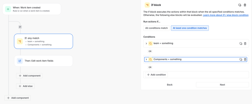

A couple of things:
  • Since your trigger listens to the work item created event, I hope we can safely assume that a team and/or component are indeed being filled out when users create a task in your project. That will be a necessary requirement for any further steps down the road.
  • Select fields on work items can be tricky to filter on sometimes, especially if they can be empty. When including a search for components, I would recommend to update your filter so it contains  "... OR (component IS NOT EMPTY AND Component IN (Manufacturing))
  • If you can't get this to work (I have no immediate idea why it wouldn't, but still), you might be able to use an IF ... ELSE condition in your automation rule instead of the JQL condition, as it allows you to split your OR statements into separate conditions. See the below example on what that might look like:

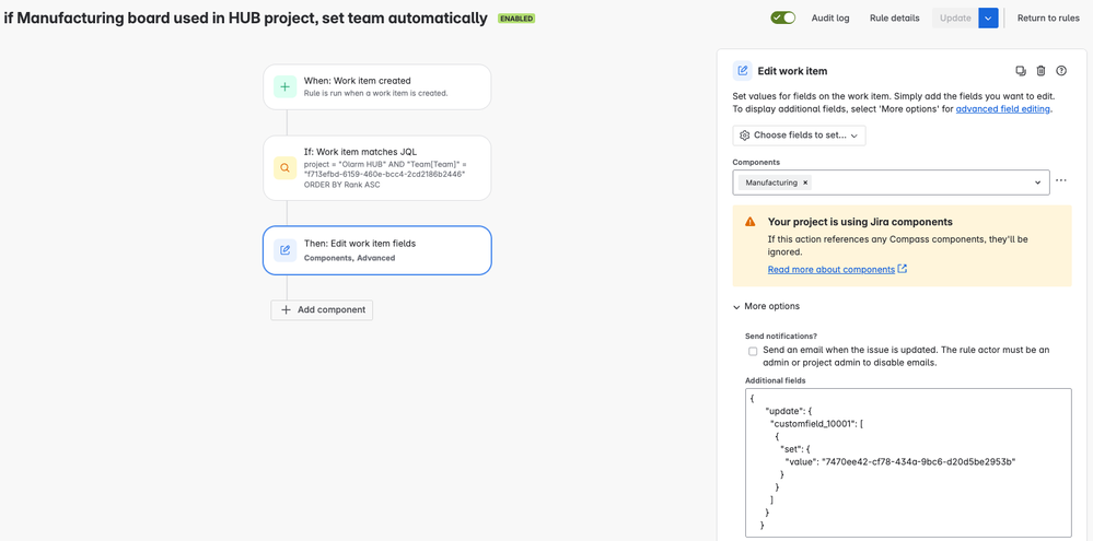

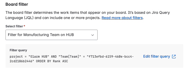

So automation with a simple JQL works fine, here is the board filter:
Here is the successful automation:
But if I have the JIRA board set with the following JQL for both, the automation does not work and does not successfully set the component and team:
project = "Olarm HUB" AND ("Team[Team]" = "f713efbd-6159-460e-bcc4-2cd2186b2446" OR component = "Manufacturing ") ORDER BY Rank ASC
Not including screenshots, it would be the same structure of the trigger details but with the above JQL
arielei
June 27, 2025
Hey @Steven Dos Ramos
Pls add a screen shot of the trigger details in your automation.
Thanks.
Steven Dos Ramos
June 28, 2025
Thanks @arielei , please see above
