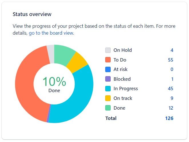

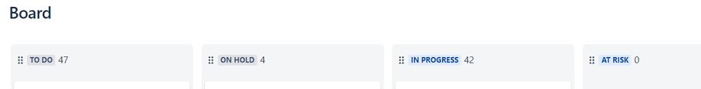

kristofdewulf
May 19, 2022
kristofdewulf
May 19, 2022
You can see above that the Board view is stating 47, 4, 42 whereas the Summary view is showing 55, 4, 45 for the same statuses.

Loretta Brunette
May 19, 2022
Hi @kristofdewulf
I think the issue here is to do with subtasks (if you're in a company managed project) or child issues (if you are in a team managed project).
The Board view doesn't take into account subtasks/child issues, whereas the summary page does. So if in your screenshot, you have 8 child issues/subtasks with a to-do status, this would be the cause.

Loretta Brunette
May 23, 2022
Hi @kristofdewulf - the query we use for the Status chart in the Summary page is
(statusCategory != Done OR (statusCategory = Done AND updatedDate >= -2w))
When you filtered the subtasks, did you do so on the Board? Because subtasks aren't displayed in the Board, the numbers won't actually update on the Board view if you filter subtasks.
Happy to jump on a call with you to run through this if easier
kristofdewulf
June 3, 2022
Thanks for the feedback. The numbers match with this query, but must say this is not intuitive at all.
