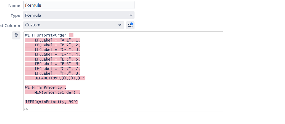

Abhinav Singhal
September 14, 2025
getting the above error, pls help
Stepan Kholodov
September 16, 2025
Hello @Abhinav Singhal
The syntax of the formula is incorrect:
- WITH statements should be like: WITH variable_name = ... :
if you want to define different values based on the existing values, you might try using the CASE() function: case(labels, "A-1", 1, "B-2", 2,..., 999)
- if you want to check the priorities of sub-issues, you need to use the aggregate function MIN{}
I hope this helps. If you have Jira Data Center or Jira Cloud, please reach out to us directly at our support portal if you have any other questions about Structure.
Best regards,
Stepan
