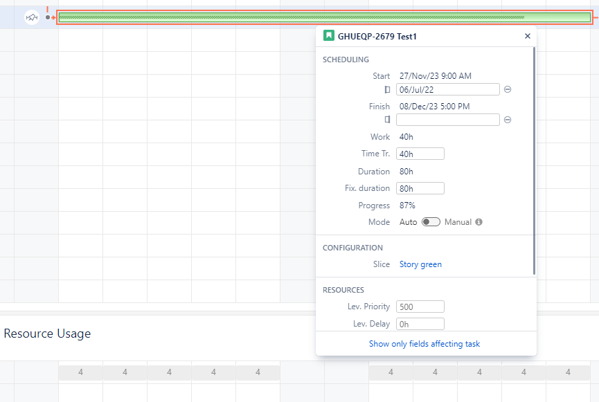

In the following picture you can see a task with the duration of 40h and the length of one week.1.1.png

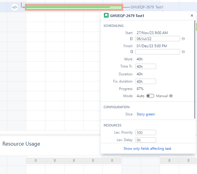

The resources are calculated right and show 8h per day. In the next step, I log 35h of work. Until this point, everything is fine.
If the task now gets delayed e.g. by one week I would just pull the end of the task to the end of the following week. Time tr. is still 40h but the fixed duration changes to 80h because it is spread over two weeks now. But if I do that, the resources will show wrong numbers, as you can see in the following screenshot.
This makes the resource planning very difficult, because it doesn't show that I was doing the 35h of work in the first week. If the task is delayed until friday of week 2 and I log the remaining 5h of work on said friday, the resources will still just show that I did 4h per day for the 2 weeks.
With many different projects and users it's basically impossible to get the resources right.

At the moment, the allocation calculation does not take into consideration the work logged.  We do have a task related to this and I have added your vote to it.
Regarding workarounds; The one you have employed is the best option at this point.
I will follow up when there is an update to share.
