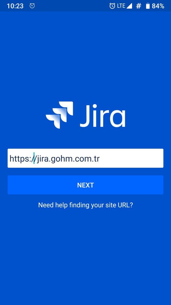

Hi,

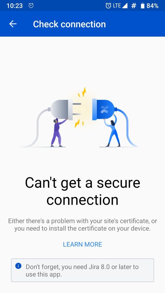

Recently I upgraded my JIRA Server to version 8.0.2. We're using JIRA behind the reverse proxy of nginx with SSL. Unfortunately, we don't have signed certificate, therefore we are using with self-signed certificate. We have no problems while using our JIRA with browser. However, if I try to connect using new JIRA Server Android Application, I got an error says "Can't get a secure connection".

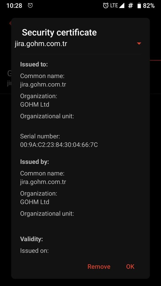

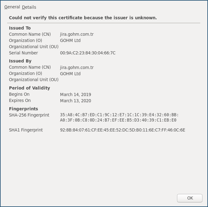

As stated in the link [https://confluence.atlassian.com/jirakb/can-t-get-a-secure-connection-error-on-jira-server-mobile-app-954244746.html], I added my self-signed certificate to my device's trusted certificates. The first following screenshot taken from Firefox Browser, and the second one is from my Android Phone. As you can see, these are the same certificate.
