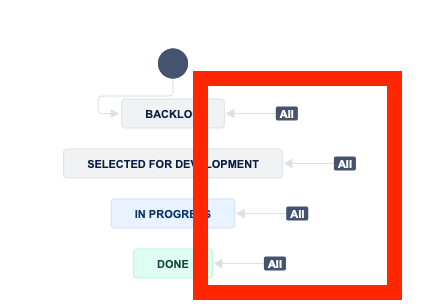

Addressing Question #3:
When workflows are initially created, the default is to allow transitions from any status to any status. This is signified by the use of Global transitions as shown here. The arrows from ALL to each status indicates that an issue can come from any/all statuses and be changed to the destination status.

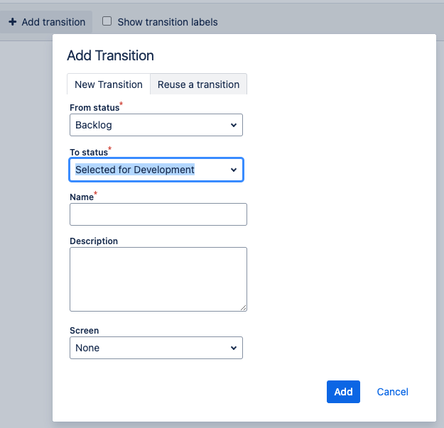

To restrict issues to following a specific path through the statuses you would need to delete those global transitions and add transitions that go explicitly from one status to another.

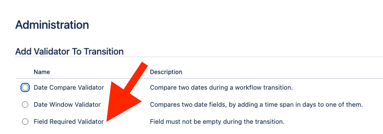

Addressing Question #2
Once you have those explicit transitions set up, then you can add Conditions and Validators to the transitions to further restrict when a particular transition can be made. Conditions will prevent the transition from being available if the conditions are not met. Validators will allow the transition to be initiated, but will require validators to succeed before the transition can be completed. In your case you would want to add Validators, specifically the Field Required validator, to confirm that the fields have been filled in.

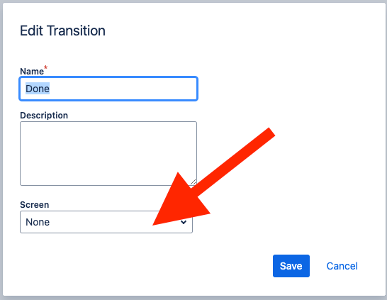

Addressing Question #1
If you want to prompt the user to answer questions during that transition then you would need to make Custom Fields to record the answers to those questions and add those fields to your issue. You would then need to create a custom Screen and put those fields on the screen. You can then associate that new Screen with the transition, and it will appear as a pop-up when that transition.
