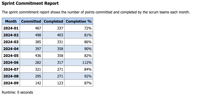

My use case is that I need to get a monthly report for multiple scrum boards covering a specific product ... so four sprints per month. I need the starting sprint points value (commitment) and the ending points value (completion) so that I can calculate a completion percentage. This is one of many automated reports I'm pulling using Jira APIs, GitLab APIs, etc.
While I can get the start and end dates from the normal Jira rest API, and I can use that to craft a JQL query to get all the work done in a sprint (being careful to set resolutiondate constraints), I couldn't see a way to get the sprint's starting point value.
I really do not want to have to manually enter start / end values for each sprint because that's error prone and basically creating a user interface where instead the data should be accessible. So, a report that used to take me several minutes to pull together by visiting a very slow velocity report for each of my teams, then manually entering data into excel, now takes upwards of 12 seconds and even less when I cache the JSON results from Jira.
Running this automatically, I was able to figure out that some of my previous reports were wrong due to human error (me). Anyway, I'll follow up with future changes if I run into them.
Here's what the end result report looks like after some quick development work.
