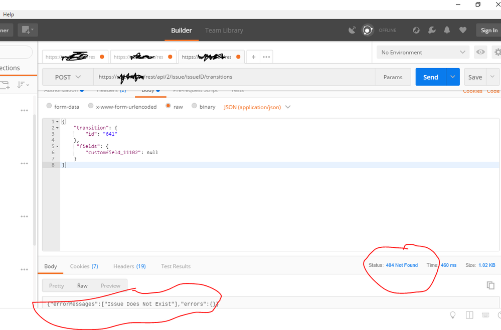

Rest API always showing 404- not found on postman status and getting response like "Issue does not exists". Following are details I am providing in postman. Any help would be greatly appreciate.
URL: https://somehostaddress/rest/api/2/issue/issueID/transitions
Method : POST
Authentication : Basic Authentication
User Name: user.user
Password: password.
JSON:   {
    "transition": {
        "id": "641"
     "fields": {
        "customfield_11102": null

A 404 on this call means your user is not logging in, the issue given does not exist or your user does not have permission to see and/or transition the issue.

Why do I have the feeling that you did not change IssueID to the actual issue id? Did you?

Did that as well before. result is same...
