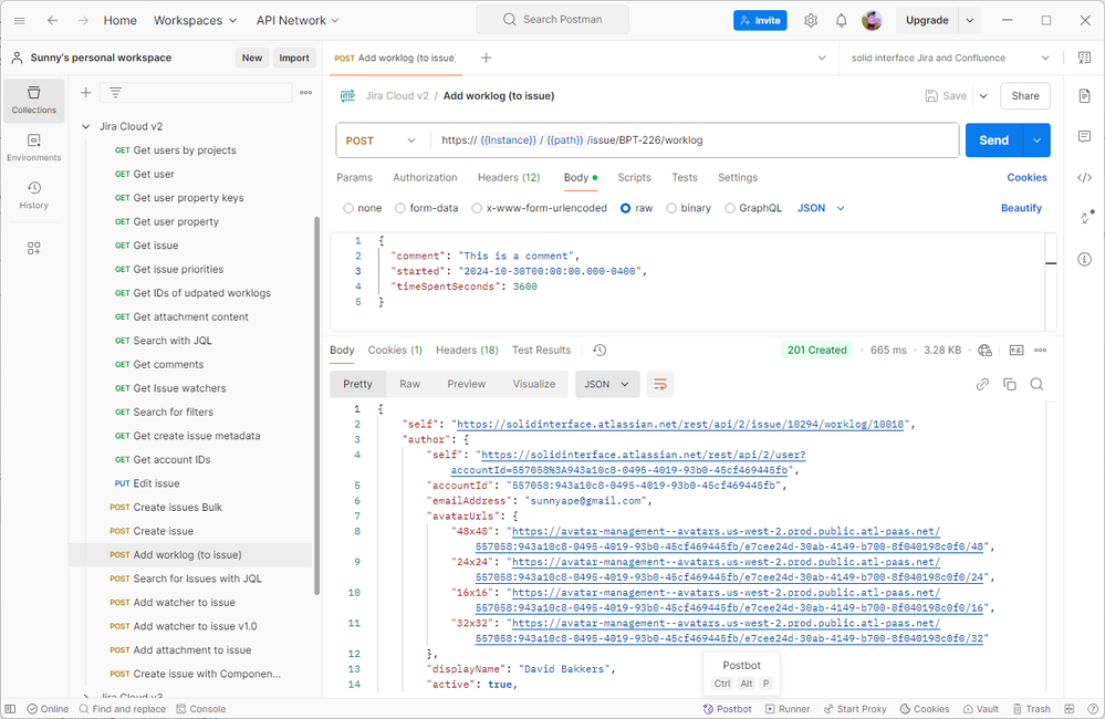

If you provide a faulty date value for the started parameter, you would normally just get a 400 Bad Request error with a "started": "Invalid date format." message, not a 500 error (which is much more serious).
I suggest you test the request and all your parameter values outside of Python. Use an API test tool like Postman to validate your request works first, thereby at least isolating the problem as being a Python fault vs a request body structure / parameter value fault.
Next, you are on Jira CLOUD right, not Jira SERVER or DATA CENTER? You've obfuscated your Jira instance's domain path as '<url for our instance>' so I can't tell.
PS. For the record, your request body is 100% valid, so it's mostly likely a Python coding mistake or some other factor that you've not tested for yet:
