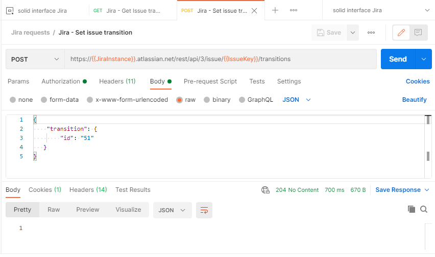

When I try that method on my Jira Cloud instance, it works just fine and the issue transitions correctly using the first ID of 51 and the response from the REST API is a code 204, not a 200. There is no message in the response body, which isn't exactly informative, but at least it works.
Here is my request, which I tested using Postman:
I tried with both the v2 and v3 REST API endpoints and both worked exactly the same.
My only observations is that your workflow has additional conditions that need to be met to transition the issue, as indicated by the 'isConditional': True in the Get Transitions response. The conditions might be that particular fields need to have values and you will have to set those field values at the same time when you are doing the transition.
Try doing the issue transition manually to the state Approve Tagging via the web interface. What happens? Do you get a warning a field needs a value or similar?
I think you should have a closer look at the workflow itself and double check exactly what needs to be done to transition the issue to the Approve Tagging status  and what the required sequence is.
