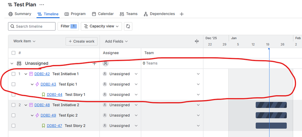

Scenario 1:
- Story 1 has no set start and due dates, is a child of Epic 1, which itself is a child of Initiative 1
- Story 1 has been added to a sprint starting Jan 14 and ending Jan 28

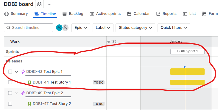

- In the Timeline view of the JIRA space that Story 1 belongs to, I see that the dates from the sprint that Story 1 belongs do roll up to Epic 1, which is expected since the timeline is configured to Schedule by sprint dates, not start/due dates
- In the JIRA plan which includes work from the JIRA space that Story 1 belongs to, there is no rollup of dates from Story 1 to Epic 1 or to Initiative 1, which is unexpected

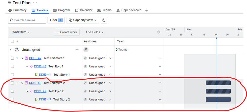

Scenario 2:
- Story 2 has a set start date of Jan 14 and set due date of Jan 28, is a child of Epic 2, which itself is a child of Initiative 2
- Story 2 does not belong to any sprints yet

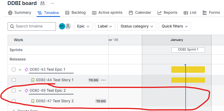

- In the Timeline view of the JIRA space that Story 2 belongs to, the start and due dates from Story 2 do not roll up to Epic 2, which is expected since the timeline is configured to Schedule by sprint dates, not by start/due dates
- In the JIRA plan which includes work from the JIRA space that Story 2 belongs to, there is a rollup of dates from Story 2 to Epic 2 and unto Initiative 2, which is expected

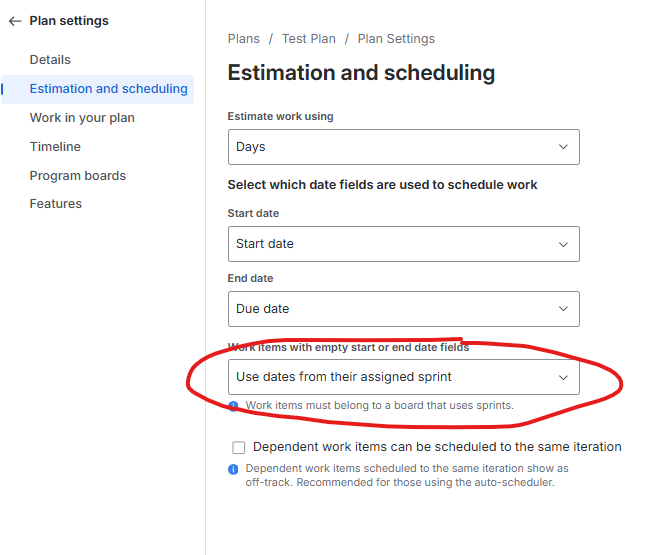

Thanks for your response. I have my plan Scheduling settings set as follows:
I don't see an option specifically called "Schedule by sprints" but shouldn't the field I circled above essentially do the same thing?

Hi @Peter Carbon ,
Yes, "Use dates from their assigned sprint" is precisely what I/you're referring to "Schedule by sprints".
