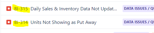

When I change my ticket status to "Done," the ticket no longer appears in my backlog/board list with the ticket number struck through.   For reference, the two tickets below are "Done," but not struck through.  Is anyone else experiencing this?  Any resolution?

This is a problem that seems to be cropping up of late. Issues need to have a resolution set. Unresolved means the resolution field is NULL in the database. This means the workflow isn't providing for setting the resolution before going the status flagged as Done. You need to fix the workflow.
The transition moving to ‘Done’ needs to one of two things; 1. Present a screen where the user sets the resolution or 2. Sets the resolution in a post function.
To correct the existing issues you can add a transition from the done status back to itself with a transition screen to set the resolution or a post function to set it. The other option is to add the resolution field to the edit screen (which you should NEVER do in production), bulk edit the issues to set the field and then REMOVE the resolution field form the edit screen.

Hi! In order  a the ticket had its number struck through must have a value (anyone) in the field resolution.
It must be set manually by de user or with a post function when you transition  to the final status.

Check the resolution of the issue. Is it resolved?
