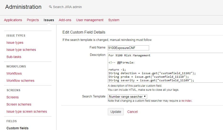

I encounter the same issue.
The description is the following
For Risk Management
<!-- @@Formula:
return -1;
String detection = issue.get("customfield_11102");
String proba = issue.get("customfield_11110");
String severity = issue.get("customfield_11109");
if ((detection != null) && (proba != null) && (severity != null))
try
String[] parts = detection.split("-");
int detection_int = Integer.parseInt(parts[0]);
parts = proba.split("-");
int proba_int = Integer.parseInt(parts[0]);
parts = severity.split("-");
int severity_int = Integer.parseInt(parts[0]);
return (float)(detection_int * proba_int * severity_int) / 1000000.0;
catch(NumberFormatException e)
return -1.0;
else
return -1.0;
Field is translated ... Do we need to put the formula in the translation too ?
David Fischer
June 20, 2019
No, it should be on the Edit screen only.

Laurent PIANFETTI
June 20, 2019
Yes, but due to CAS in front of our Jira, the URL is not accessible directly.
David Fischer
June 20, 2019
Then adjust the domain name of the URL. That URL has to be accessible, otherwise you wouldn't be able to configure the custom field...

David Fischer
June 20, 2019
And does it show the exact same formula you posted? Can you post a screenshot of that page? And also post the full error with stack trace (right above the link)?

David Fischer
June 20, 2019
And the error is that the formula cannot be found for this field?
I don't see the end of the formula on the screenshot. Can you post a screenshot of that, just in case the formula isn't properly closed?
Can you also try to replace the whole description with a simple formula (in case there's a hidden character or something)?
Of course, you can also upgrade to JMCF 2 where configuration is much simpler (and scripting much more powerful)
Laurent PIANFETTI
June 21, 2019
The formula I have paste in previous message is the same ... No extra characters.
What I understand reading your post is that the plugin access the edit field via the same URL ? I'm surprized to see that the plugin doesn't use internal API of Jira to get this info.
But what are the credentials used ?

Laurent PIANFETTI
June 21, 2019
Message is :
Navigate to the following URL to edit the formula: masked_url/jira2/secure/admin/EditCustomField!default.jspa?id=11107
2019-06-21 11:24:33,982 http-nio-8080-exec-34 WARN user1 684x528427x3 yk56hp 194.214.141.5,10.7.201.83,10.7.214.12 /rest/api/2/search [c.i.jmcf.fields.CalculatedNumberField] CalculatedNumberField: could not find formula in custom field description of field 9100 Exposition (customfield_11108)
Navigate to the following URL to edit the formula: masked_url/jira2/secure/admin/EditCustomField!default.jspa?id=11108
2019-06-21 11:24:34,099 JiraTaskExectionThread-45 WARN user2 684x528426x2 1tmnxid 10.94.32.117,10.7.214.12 /secure/CloneIssueDetails.jspa [c.i.jmcf.fields.CalculatedNumberField] CalculatedNumberField: could not find formula in custom field description of field 9100 Exposure (customfield_11108)
David Fischer
June 21, 2019
Hi,
this error message is for a different field than the one in your screenshot (field "9100 Exposition" - customfield_11108). Did you navigate to the corresponding URL (masked_url/jira2/secure/admin/EditCustomField!default.jspa?id=11108)?
Also, depending on your version of JMCF, since you're using translated descriptions, you might want to try adding the formula to the translated descriptions.
