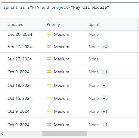

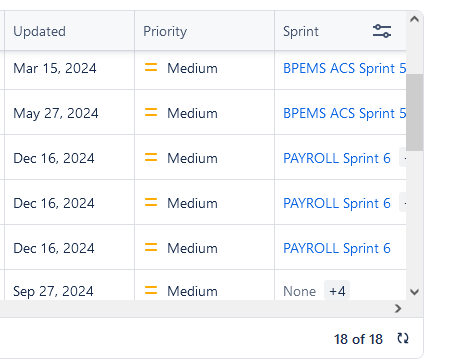

Sorry Boyan, I am still facing the issue as when exported rows using the previous JQL, it's still showing some issues which are having values in sprint column in xlsx!

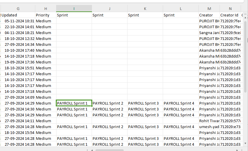

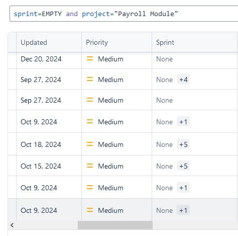

Chandrashekhar Kavi
December 20, 2024
Boyan Iliev
December 20, 2024

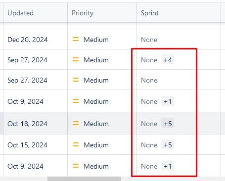

I'm still a bit unsure of what you try to do, but here is my guess - you do not want to see the tickets in the screenshot above as you consider them not in a sprint. Yet these tickets were in sprints that are now closed. This is what the "+4" shows next to "None" - 4 closed sprints.
What you should do is filter out Empty(as you did) OR if sprint is closed, while at the same time the not placed in any open or future sprints. Try replacing "Sprint is Empty" with something like this "(Sprint is Empty or Sprint not in (OpenSprints(),futuresprints()))".

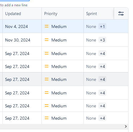

Chandrashekhar Kavi
December 20, 2024
Hello,
My purpose to get list of issues which are having statuses (todo, new, archived, dolater) and sprint is empty and assignee is not empty. But as I shared image earlier it's showing issues with something like +4, which I don't want in the list.

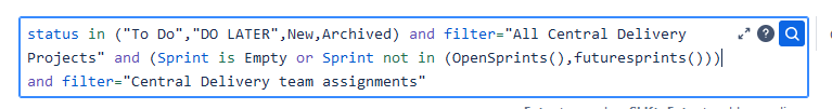

Please try replacing "Sprint is Empty" with "(Sprint is Empty or Sprint not in (OpenSprints(),futuresprints()))" and let me know if it works.
Chandrashekhar Kavi
December 20, 2024

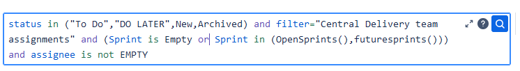

I tried with the above JQL, but it not worked for me! it's showing more records now where result is expected to no rows.
Boyan Iliev
December 20, 2024
It should be
... or Sprint not in ...
you added just
... or Sprint in...

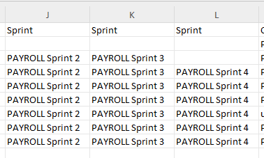

Chandrashekhar Kavi
December 20, 2024
When checked in excel, it's showing records as below, It should be displayed a single record, but it's showing 8 records!

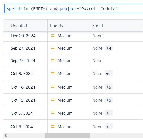

Hi, I have misunderstood you. If you are still working on this, can you try one more thing? Replace everything I suggested
with
Sprint in (EMPTY)

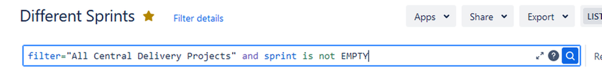

Chandrashekhar Kavi
January 2, 2025
Boyan Iliev
January 2, 2025
This is strange, do you know what the "Central Delivery Projects" filleter does? Is it possible that it adds these extra tickets?

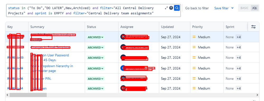

Chandrashekhar Kavi
January 2, 2025
Tried all the way, no result change!
Chandrashekhar Kavi
January 2, 2025
Boyan Iliev
January 2, 2025
Well I have no explanation. I'll try to dig around, but in the mean time, my best suggestion is to filter it in excel itself.
  1. Find all "Sprint" columns
  2. Delete all but the first one
  3. Filter the first by value - if it has value, row it should be deleted
  4. All remaining rows should have no sprint
I'm not sure what amount of data you are dealing with, if this is a recurring extract or a one time thing, so based on the above you might need some automation.
