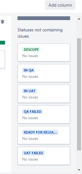

The next step for you is to look at the actual status of issues - I am guessing the status "in progress" is in the grey column to the right, but scrolled out of sight.
That grey column is the list of status that are not mapped into columns.  The board will only show you columns, and the cards (issues) in the status that are in those columns.  If an issue is not in a status mapped into a column, it can't appear on the board.
So, I think there's a very simple answer here - scroll back up to find "in progress" in the grey column, and drag it into the middle "in progress" column.  Issues that are in progress will then show on the board, in that column.

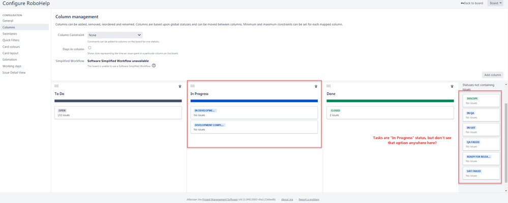

James Daniel
September 9, 2021
The problem is that this "In Progress" status does not appear anywhere in the grey column. The screenshot below is the only statuses appearing on here. If you scroll down or up, there is nothing else outside of these. That is the issue I am having, that this "in Progress" status isn't appearing anywhere for me to map it into a specific column on the board!
Nic Brough -Adaptavist-
September 9, 2021
Ok, that means your board is not selecting for any issues that have a workflow that includes the "in progress" status.
What does the board filter say exactly?  (Obscure the names of the projects or fields if you want, it's the general rule we're looking for).
"Project in (XYZ, ABC) and issuetype in (bug, feature, wombat)" is the sort of thing we need to see.

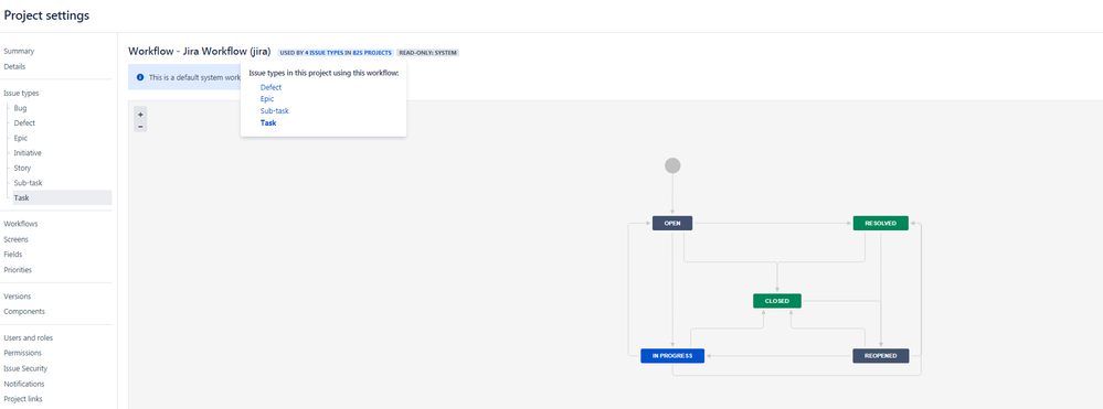

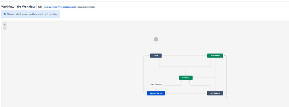

James Daniel
September 9, 2021
Moving the ticket from Open to In Progress by clicking on the "Start Progress" button in the actual Task issue itself. Afterwards, the status of the ticket is showing In Progress.JiraWorkFlow.png
September 9, 2021
Ok, the only thing I can think of that could be wrong is that project xyz is not using that workflow
If it did, then the board column mapping screen would be listing in-progress, resolved and reopened as well as open and closed.
Another thing that makes me think that the workflow is mismatched is that the open in the workflow has a blue category, but the one in the board column mapping is grey, implying there are two status called open as well.

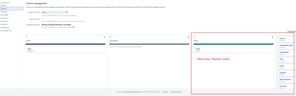

James Daniel
September 9, 2021
The crazy thing is that I do not see the Resolved status either in the unmapped column? And when I access the workflow itself, it says it is being used in the current project for even the specific Issue Type "Task" that we are having a problem with! The mystery continues :(NoResolvedStatus.pngJiraWorkFlow.png
