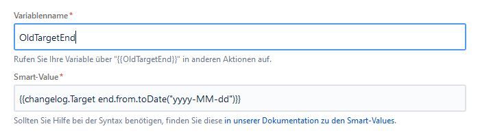

I suppose that I will need to convert the output to a date format to do some maths...
{{changelog.Target end.from.toDate("yyyy-MM-dd")}}
...returns something but not the output, which I expected:
Output:  Fri Nov 15 00:00:00 CET 2024

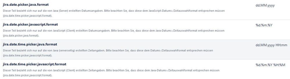

When you added the format string of "yyyy-MM-dd" to the toDate() function that helped with the conversion, and the resulting date / time value appears to be returning in whatever your system and profile are using for date / time formats.

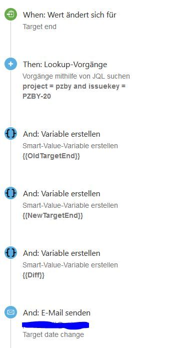

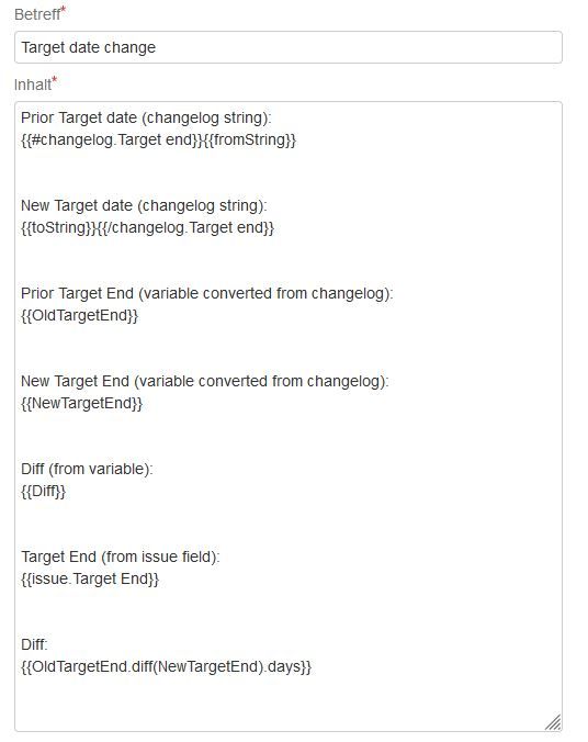

Here's the rule and all the steps to set variables, mail config and mail output:
Thanks,
Patrick

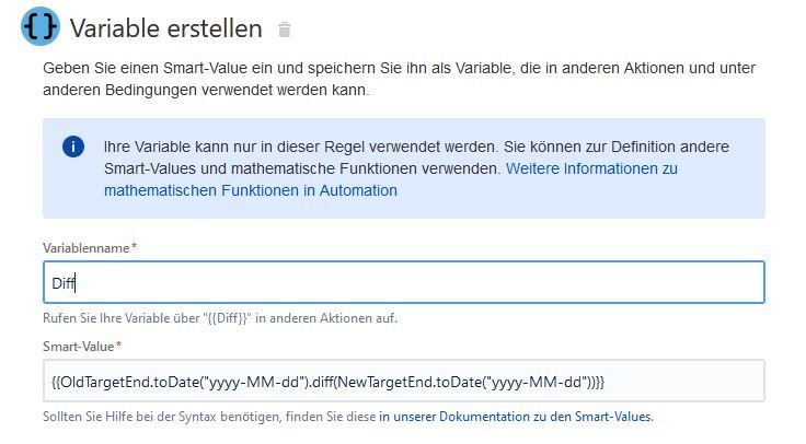

When you create a variable, that is stored as a text value.  Those variables need to be converted to date before using the diff() function.
In your create of the "Diff" variable, that would be this, adding the missing units of measure, days:
{{OldTargetEnd.toDate.diff(NewTargetEnd.toDate).days}}
One more thing: when creating variables, I suggest adding a prefix to ensure the name is always unique and will not collide with other fields or rule features.  For example, consider renaming that variable from Diff to varDiff by adding a prefix of var to symbolize it is a variable.

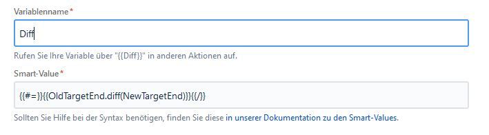

Hi @Bill Sheboy
I've got no luck with the new diff variable
{{OldTargetEnd.toDate.diff(NewTargetEnd.toDate)}} doesn't work, neither does
{{#=}}{{OldTargetEnd.toDate.diff(NewTargetEnd.toDate)}}{{/}}
Both result in an empty output and the audit log has no errors.
Same with...
{{OldTargetEnd.toDate("yyyy-MM-dd").diff(NewTargetEnd.toDate("yyyy-MM-dd"))}}
{{#=}}{{OldTargetEnd.toDate("yyyy-MM-dd").diff(NewTargetEnd.toDate("yyyy-MM-dd"))}}{{/}}

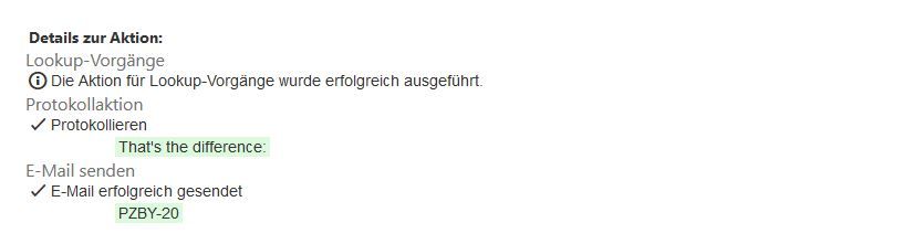

There is a rule Log action which allows writing any value to the audit log when the rule executes:
https://confluence.atlassian.com/automation/jira-automation-actions-993924834.html#Jiraautomationactions-logactionLogaction
Writing the variable to the log will help identify what is happening.
Patrick Schmidt
January 24, 2024
Hi @Bill Sheboy
thanks for the hint. Unfortunately the audit log also shows an empty variable.

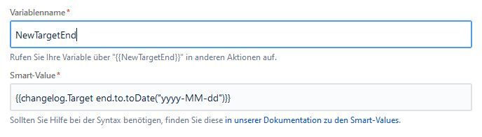

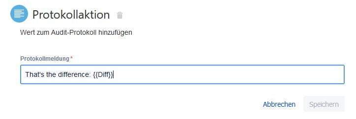

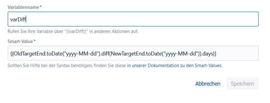

Please show images of:
  • action details to create your variable
  • audit log details showing the rule run writing out that variable
Patrick Schmidt
January 28, 2024
Hi  @Bill Sheboy
sorry I must have missed your reply. Here are the images:
Thanks,
Patrick

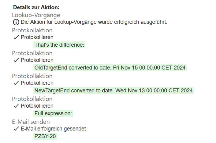

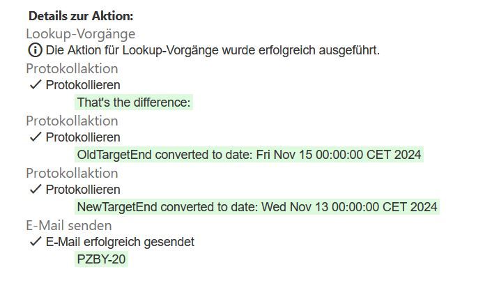

FYI: I recommend adding a prefix to variable names for rules and not using anything similar to built-in functions and features, such as "Diff".  That will avoid errors / confusion from any typos.  For example, perhaps name that variable varDiff.
Also, please add writes to the audit log of the converted, variable values:
  • OldTargetEnd converted to date: {{OldTargetEnd.toDate("yyyy-MM-dd")}}
  • NewTargetEnd converted to date: {{NewTargetEnd.toDate("yyyy-MM-dd")}}
Those will confirm the conversions work prior to use in the diff() function.  Then re-test your rule.

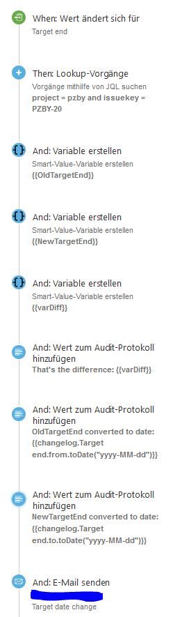

Finally, would you please post an image of your complete rule?  That may provide some context to explain why the value is null.

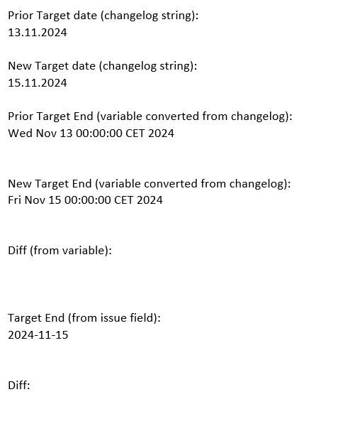

here's the audit log with the new entries:
...and the rule. The definition of the variables can already be found above:
Thanks,
Patrick
