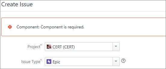

I've a Behaviour script in initiator for create screen only for project x and its IssueTypes.
Now i'm getting the below error in another projects create screen which is having separate workflow and create screen.
Can anyone help me on this ?

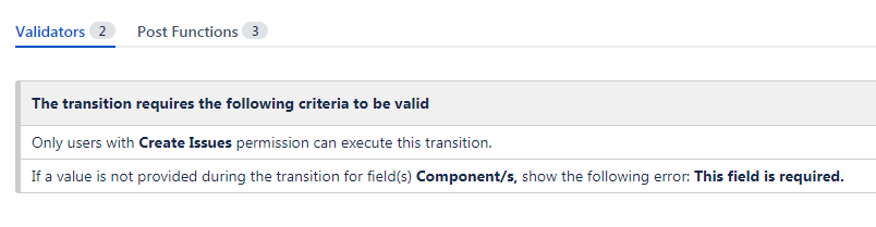

Not sure if this what you mean, but I am talking about the create transition validators :
image.pngOtherwise, I would check if there is a specific context for this custom field, and lastly check the behaviours again, or any other app that could have this functionnality.
