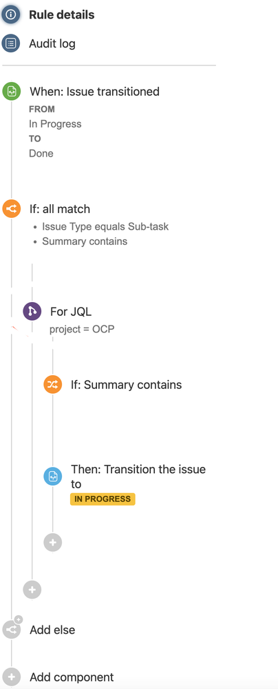

Hello all,
I need help with one task related to JIRA Automation.
Scenario:
I have 10 or more main/parent tasks. Each of them contains exactly the same number of sub-tasks, with exactly the same naming convention. I'm preparing a rule that after changing the status of one of the sub-task will change the status of another sub-task. Since each subsequent created main/parent task will have exactly the same sub-tasks, with the same names, I generally use assumptions related to the names. The rule works, but unfortunately, it changes the status of subtasks from each main/parent task.
Now, according to my rule, when I change status of Sub-task A from Task 1 it changes status of Sub-Task B from Task 1 (according to expectation), but in the same time it changes status of Sub-task B from Task 2 and Task 3.
The question is, what I have to add to my rule so that the rule only works on sub-tasks from one main/parent task. So, when I change status for Sub-Task A from Task 1 it only changes status for Sub-Task B from Task 1.
I will be grateful for your help :-)
Thanks

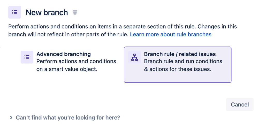

Hi Przemek,
I think you want to edit sub-task of specific trigger task issue.
Please try "New branch" which could action on other related issue.
And choose "JQL" condition to filter your target issue.
I think maybe the problem is that JQL didn't response the correct issue object.
regards,
Iris Chen

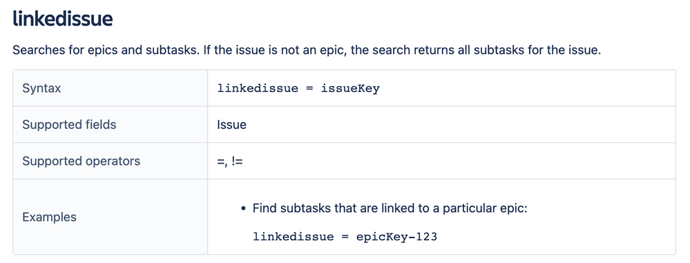

Deleted user
April 20, 2022
Try this JQL "linkedissue" to limit the scope and filter your target issue!

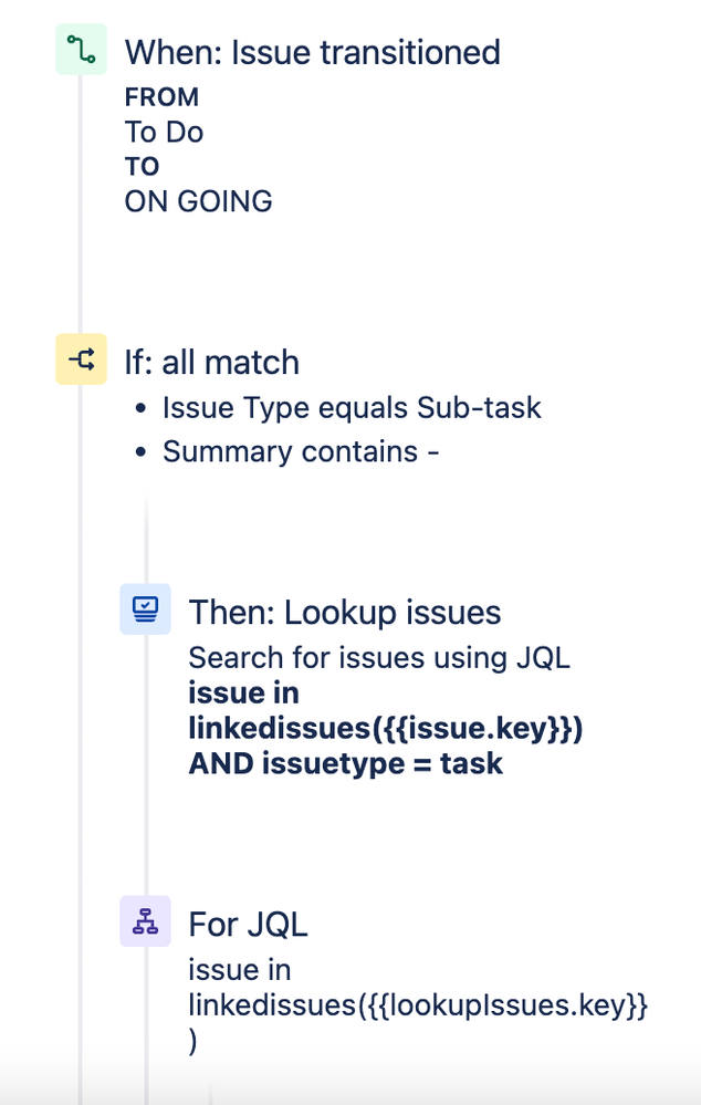

Hi Przemek,
I am not sure if it work, but try to use action "Lookup issues" first to get the main issue key.
Then use branch to filter your target sub-task issue.
See the example below.  Hope it helpful.
regards,
Iris Chen

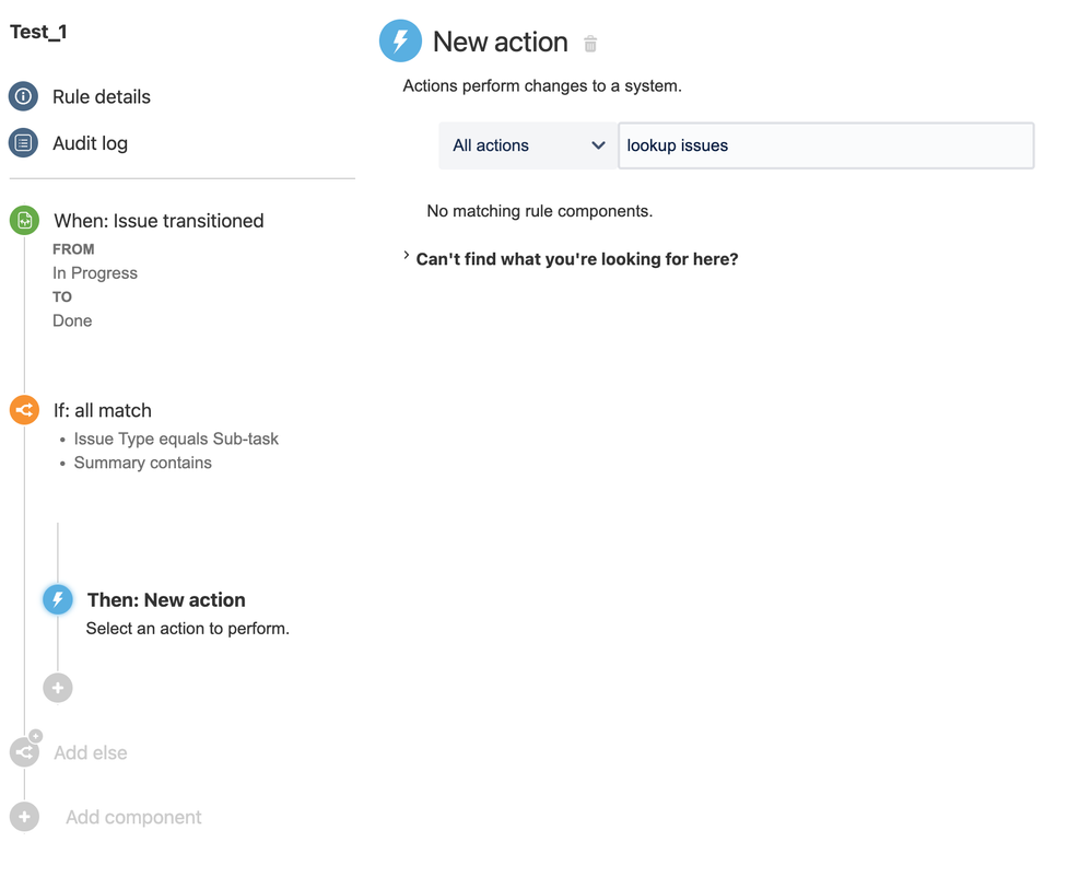

Przemek
April 20, 2022
Hello Iris,
Thank you for constantly support :-)
It's seams that I have different version of JIRA or something because I don't see this action on my list :-(
