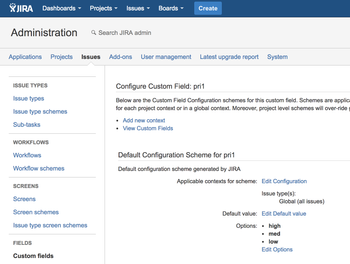

Alternative to that, you might be able to get around this problem by changing the configuration of the custom field in Jira. Right now your custom field looks something like this in the Jira UI under Issues -> Custom Fields:
There are a couple of different changes you could make to this field in order get around this.
1: You could set a default value for this field here. That way you don't have to set a value in your rest call when creating the issue for issues unless the issue needs to have a different value here
2: You could create a new option for this field, and call it something like "unset" or "none".
Or you could do both of these steps. In which case you could then use the rest call to set the field value to "none". The difference here though is that this issue would have an actual value for that field when it is created as compared to being a true Null. It might not make a difference, but it is a subtle change that is worth noting.
