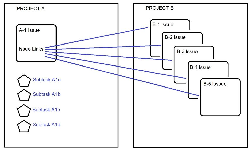

I'm trying to get an issue to close under the following conditions:
Project A (Main Project)
Issue A-1
Subtask A-1a
Subtask A-1b
Subtask A-1c
Subtask A-1d
Project B (Linked issues to Project A)
Issue B-1
Issue B-2
Issue B-3
Issue B-4
Issue B-5
- All Linked issues from Project B must be Closed or Cancelled
- All Subtasks under Project A must be Closed or Cancelled
- If all of the above items are valid then close Issue A-1

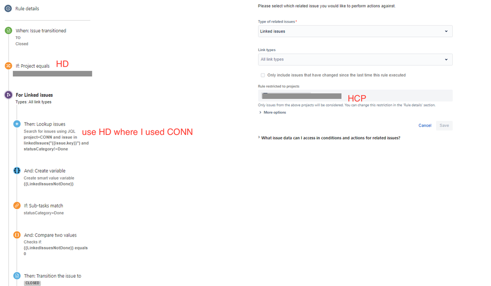

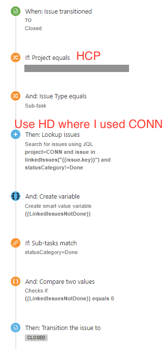

Here is the rule for when a subtask has been transitioned. I have not run this rule to test it, but I believe it will work.

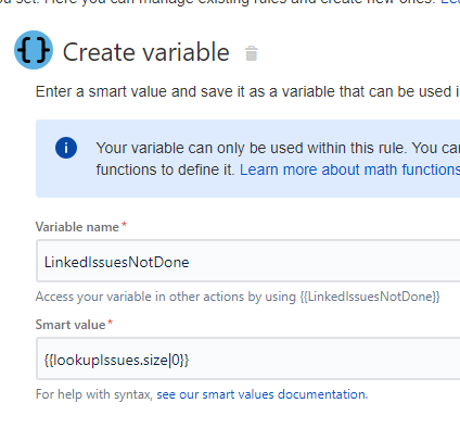

This is the Create Variable step

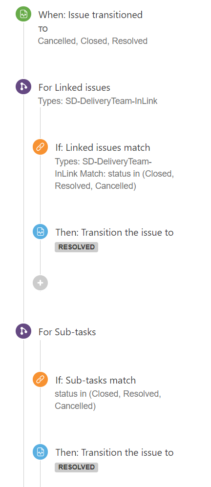

The rule for when a linked issue in HD is closed is very similar. However, since the trigger is the HD issue, you need to use a Branch to shift the focus to the HCP issue to which it is linked.
For debugging purposes I would recommend that you use a Log action rather than a Transition Issue action, until you are sure the rule is getting the expected results. for the comparisons and Lookup.

Thanks for the help, I'm half way there.
The second rule for HD links works without problems.

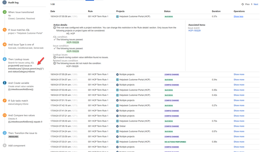

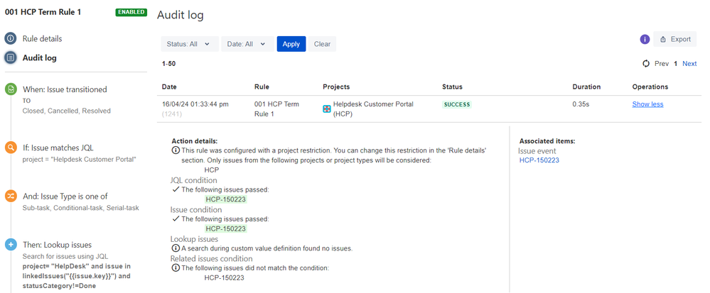

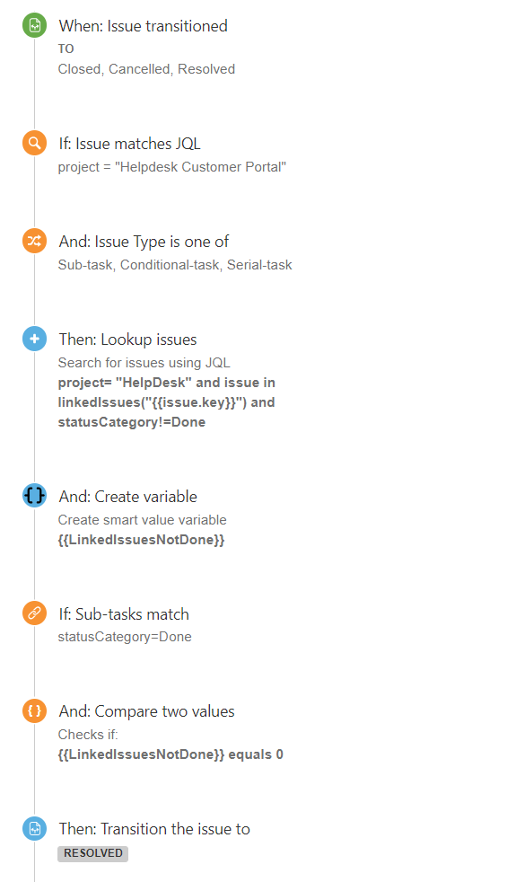

The first rule for the HCP Subtasks does not work. It claims that it successful, however the status does not change.
Here's the rule and Audit Log

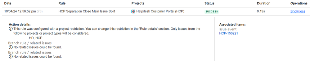

Trudy Claspill
April 17, 2024
Hello @AndreH
Notice the first statement in the Audit Log:
It would appear that you set up the subtasks rule to be scoped to a single project. That rule has to be scoped to multiple projects and specify both the HD and HCP projects. Both rules have to be scoped in that manner.

Trudy Claspill
April 17, 2024
I apologize. I see a mistake in the rule I provided to you for the sub-task scenario.
In the Lookup Issue action the JQL needs to be changed.
Instead of {{issue.key}} use {{issue.parent.key}}
AndreH
April 18, 2024
Still doesn't find any items and no status change.
Trudy Claspill
April 18, 2024
I'm going to walk through my debugging process...
In this last execution the issue that triggered the rule is HCP-150229. This is a subtask issue.
{{issue.parent.key}} is the issue key for that subtask's parent issue.
The Lookup Issues task says it is not finding any issues. That indicates there are no not-Done HD issues linked to the subtask's parent issue.
The final message in the log is that the trigger issue HCP-150229 doesn't match a condition. That would be the "Subtasks match" condition.
And now I see the problem with the solution I suggested. Since it is a subtask that triggered the rule, this condition will not work. This condition is trying to evaluate the subtasks of the trigger issue, which itself is a subtask.
One solution is to use another Lookup Issues action to find out if there are any sibling sub-tasks that are not Done, similar to what is done for the linked issues.
statusCategory != Done and parent={{issue.parent.key}}
Then add a Smart Values condition to check the size of the results:
{{lookupIssues.size|0}} equals 0
