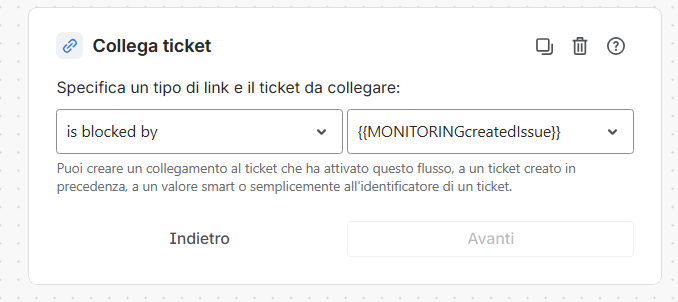

Hi Gabriela, thanks for your in deep answer! I tried to proceed as you have suggested, so I have a smart value after a work item is created, for example:
MONITORINGcreatedIssue = {{createdIssue.key}} (in the MONITORING project)
Now, it seems that the linking part is not working as expected, I am using the correct item? Here a screenshot (in Italian, sorry):
Also, I am sure that the smart value is working, I tried to "print" it directly into the task description, and I have the key.
What I am doing wrong? Thanks for your time!
Gabriela
July 12, 2026
Don't name the variable createdIssue — that clashes with the built-in {{createdIssue}} smart value, so referencing {{createdIssue}} downstream gets ambiguous. Rename it to something unique like task2Key, and reference {{task2Key}} in the link step.
The bigger thing is usually the Link work items action itself: it links whatever issue is currently in scope at that point in the rule. So the order matters — right after you create story1 (while it's the most-recently-created, in-scope issue), run Link work items → "is blocked by" → {{task2Key}}. If a later Create (the subtasks, or story2) has already run before the link step, the in-scope issue has moved on, and the link lands on the wrong item or with an empty target.

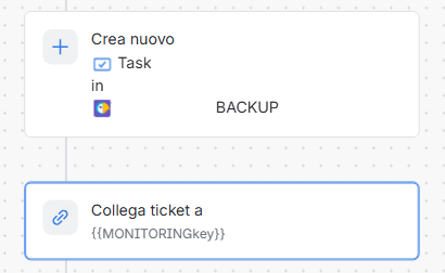

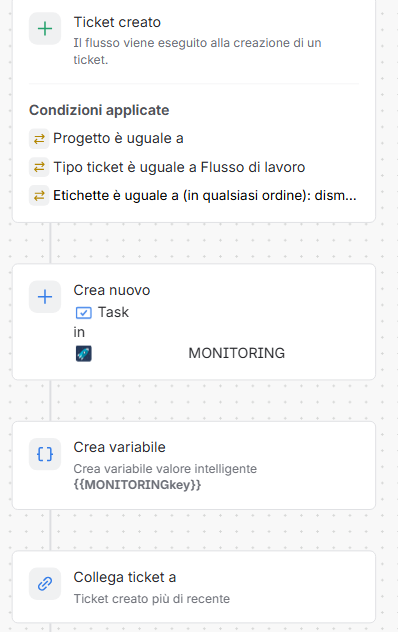

Hi Gabriela, I'm providing 2 actual screenshots of what I am working on right now:
So, basically, if an Epic is created in a specific project (deleted in this image) with a specific label, I want to have a ticket created in the MONITORING project, I create the MONITORINGkey variable and I link the just-created task to the just-created Epic in the blanked project. Now, this part just works.
Here comes the second part:
after the MONITORING task + linking to the main Epic + setting MONITORINGkey, I proceed to create a Task in the BACKUP project, and I want to link it to the MONITORING task just created. This second part does not work, at the moment.
Gabriela
July 12, 2026
That confirms it, and it comes down to what the rule treats as the "current" issue. Your trigger is the Epic, so the Epic stays the in-scope issue for the whole rule. When you link the MONITORING task, the Link work items action is really linking the in-scope issue (the Epic) to MONITORINGkey — which is the pairing you want, so it looks like it works. When you reach the BACKUP task, the in-scope issue is still the Epic, not the BACKUP task you created a step earlier, so the second Link action tries to link the Epic again instead of BACKUP to MONITORING.
Two ways to fix the second link. The cleaner one is to link during creation: in the Create work item action for the BACKUP task, open More options / Choose fields to set, add the Linked issues field, pick the link type, and reference {{MONITORINGkey}}. That links the BACKUP task itself to the MONITORING task in the same step, with no separate Link action.
If you'd rather keep a separate Link action, add a Branch on "Most recently created work item" right after the BACKUP create — inside that branch the in-scope issue is the BACKUP task, so a Link work items action there links it to {{MONITORINGkey}} correctly.
The same applies to your first link, by the way — it lines up on its own only because the Epic you want on one end is already the in-scope issue there.
