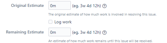

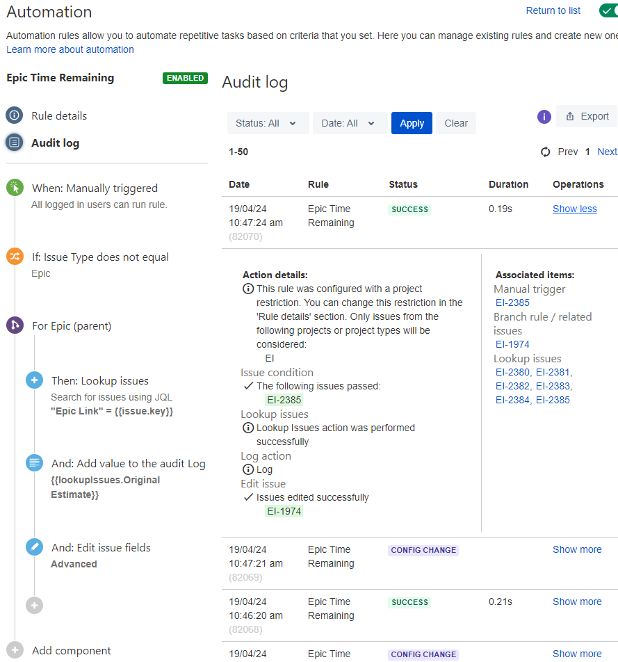

Currently I'm writing an automation which will sum all of the Original & Remaining Estimates for an Epics' children. The issue is that it is returning with 0 min. The children have been verified to have various timetracking values, but I'm having difficulty accessing them within logging.
After running this script on a child of an Epic it updates the Epics time estimates to 0m.
Any help would be greatly appreciated.

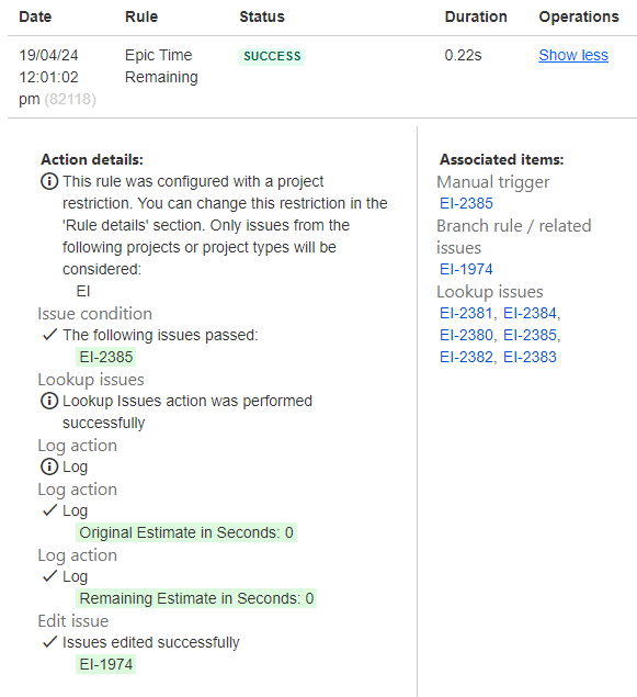

nicholas kurtz
April 19, 2024
@Bill Sheboy
Sorry to say that they are reporting 0's.

Thanks for checking those fields.  I just reviewed the open suggestions and found the Lookup Issues action for Jira Data Center does not yet support those fields: https://jira.atlassian.com/browse/JIRAAUTOSERVER-877
The same thing happened when Lookup Issues was added for Jira Cloud, and it was about a year later when all of the other fields were added.
For now with your current scenario, there is only one work-around:
  • Use the Send Web Request action, call the REST API function for an issue search
  • Then use the response the same way a lookup result would be used to sum the fields
