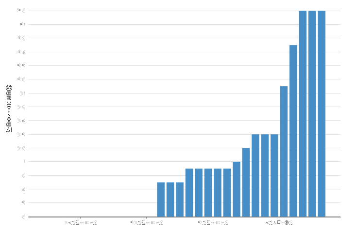

I've installed jira 7.6.1 & ServiceDesk.
On my dashboard, some of my widgets are not correctly displayed.
Previously, I had a problem with titles as described here . An update on the configuration and a reboot solve the issue.
But now, i have some widgets correctly displayed and some others are not.
Here is an exemple of a bad gadget. Is anyone able to help me this issue ?

This looks like it is caused by missing fonts, try installing the fonts suggested in the following documentation and see if it helps:
https://confluence.atlassian.com/confkb/confluence-ui-shows-garbled-or-corrupt-text-on-captcha-macros-and-or-diagrams-due-to-missing-fonts-938027858.html
https://confluence.atlassian.com/jirakb/jira-ui-shows-unreadable-text-on-captcha-and-some-gadgets-due-to-missing-fonts-941590036.html
