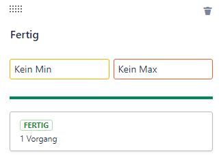

i have board (scrum and kanban) 1, 2, 3, 4, 5. all are using one issue type "IT".
this issue type "IT" from all boards should appear on one new board "summary" with the colums new / todo / done. done should show every done task.
in the shared filter for "summary" i see all issues of the type "IT".
when i edit the columns to assign the status it says for done "1 process".
this is the process i am missing.
Tarun Sapra
August 10, 2018
what do you mean by 1 process?

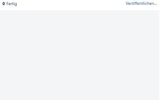

David Müller
August 12, 2018
sorry for the late answer
the summary board is kanban, in the attached files you should see what i mean
and the column is empty
