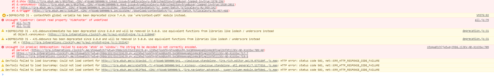

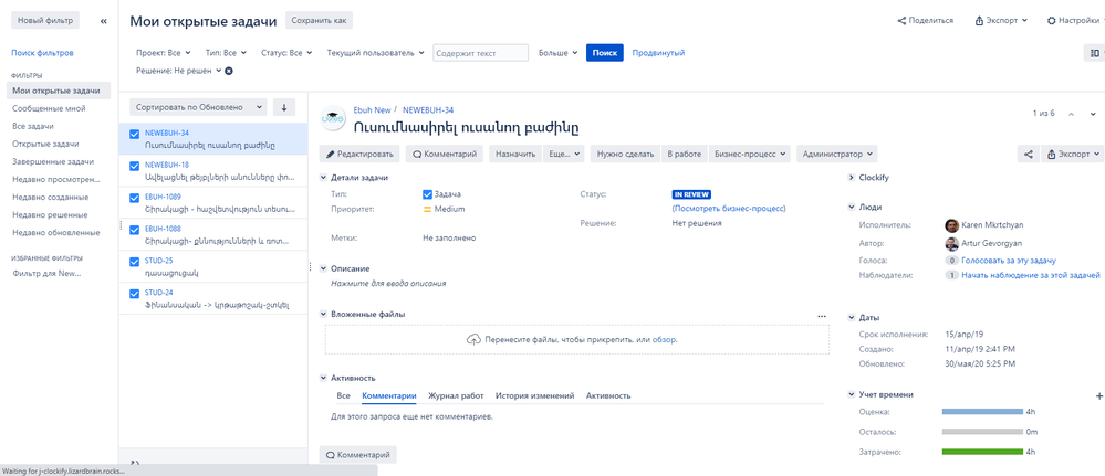

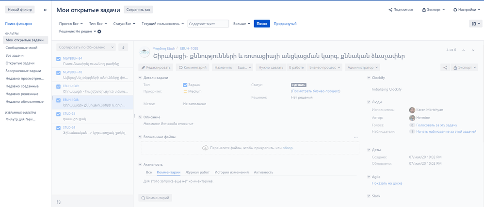

Everything is fine except , when i trying to search my open issues,
after choosing one issue, the screen and the all fields on it getting like disabled,

Issue comes from plugin Clockify.
After reinstallation it was fixed.
