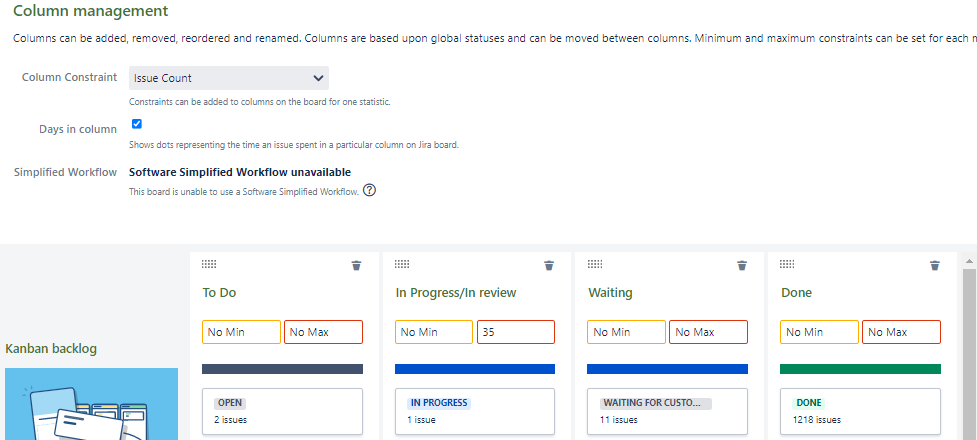

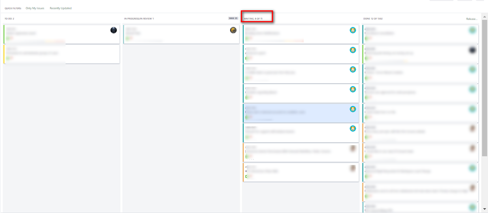

Hello Community!
Could you help me understand how is it possible that some issues that are not updated longer than 2 weeks are no longer shown on Kanban Board. I can even see in the colum heading "WAITING 8 OF 11", so 3 issues are not shown.
I have noticed that it happens to status "Waiting for Customer" (status category "To do"), status is not used in last column and the resolution of issues is "Unresolved".
We do use functionality to hide completed issues older than 1 week. But I guess this should work for issues in last column only.
I will grately appreciate your help!
Kind Regards.

Anna Bartczak
April 14, 2022
Filter Query: project = J4BS ORDER BY Rank ASC
Kanban board sub-filter: fixVersion in unreleasedVersions() OR fixVersion is EMPTY
I do not use versions, so all my issues have fixVersion empty.

Hi @Anna Bartczak
Your image of the board is truncated.  Would you please show the entire image to show if any of the quick filters or people/assignees are selected?  Selecting a quick filter or assignee would definitely hide some issues.

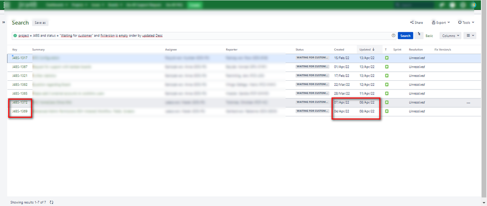

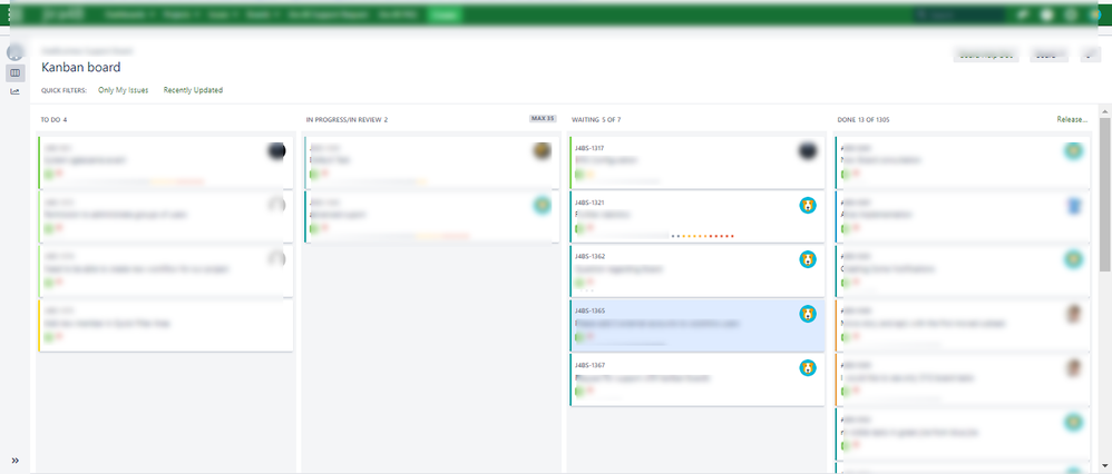

Anna Bartczak
April 15, 2022
Hello @Bill Sheboy
There is no quick filter selected and no swimlanes applied. Below I am attaching again print screen of the board and the results of the JQL.
The last two issues form the JQL query are not visible on the board and they were updated last time one week ago (today is 15.04.22 and they were last updated 08.04.22). That is the only logic I can see... It seems like "hide completed issues older than": 1 week is affecting this column - which is not the last "Done" column :(.

Bill Sheboy
April 15, 2022
Thanks, Anna.  It would seem the issues are encountering a couple of things:
Hide completed issues is using Updated versus Resolved: https://jira.atlassian.com/browse/JSWCLOUD-21897
And for Jira Server, Hide Completed issues is impacting columns other than the last one on the board: https://jira.atlassian.com/browse/JSWSERVER-20229
One suggested work-around is to disable the feature (show all issues instead) and use a Kanban board sub-filter on resolution: resolution = Unresolved OR resolved >= -1w
One side-effect of this work-around: when issues are accidentally closed/reopened and in-progress for longer than a week they could vanish from the board.

Anna Bartczak
April 22, 2022
Hello @Trudy Claspill @Bill Sheboy
Thank you so much for your answers. It's very helpful to confirm that sth is actually not working as expected!
I have removed a sub-filter (this did not help, maybe it would work for new issues) and then used the sub-filter suggested by Bill. In my case the resolution is cleared when ticket is re-opened, so I should not encounter any side effects :)
Thank you :)
