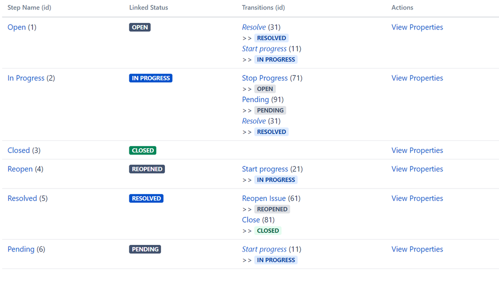

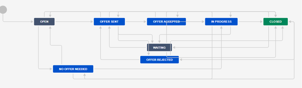

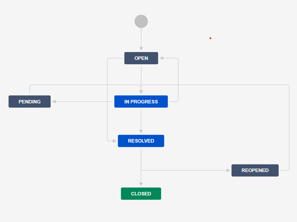

The workflows look fine. Do you have any Automation rules or scripts which can transition issues to the status No offer needed?

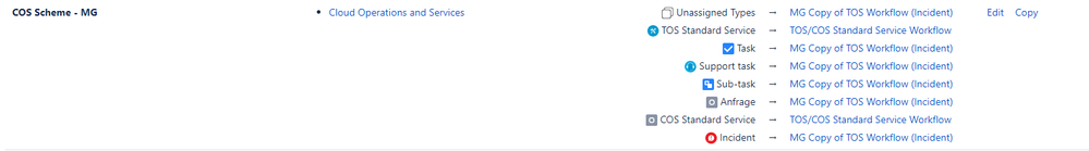

Could you send a screenshot of the project workflow scheme (Project settings > Workflows)? Just to see what issue types the workflows are assigned to.

Here you find the attached picture of WF schema assignment. Let me know if you need anythingWF Schema.png else.
Kseniia Trushnikova
August 18, 2023
@ritu gurdatta, okay, workflow inconsistencies is my last guess. You can check it with the SQL query or by making a copy of workflow.
