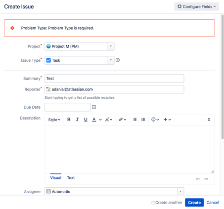

However, I was presented with the following error when I tried to create a new issue in the Project M screen below:

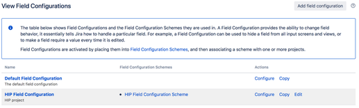

I reviewed the Field Configuration  again and noticed that it is due to the fact that the default field configuration is being used by all my projects here:

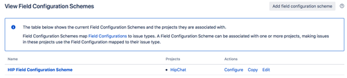

To overcome this, I went ahead and created the following to cater for this project only:
  • Field Configuration
  • Field Configuration Scheme
As you can see, it is different from the default field configuration and I assign them specifically to the HipChat (HIP) project. Under the field configuration, I made the Problem Type field required and verified that I don't encounter the same problem again.
