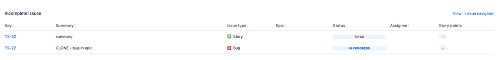

From the Reports section of the agile board you can review the sprint Burndown Report to see all the issues that were in the sprint, which includes a section for incomplete issues.

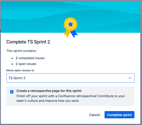

Also, when you click the Complete Sprint button you should be getting a pop-up that tells you how many issues where completed and how many issues are incomplete, including an option to move the incomplete issues to the backlog, a new sprint, or an existing sprint.
