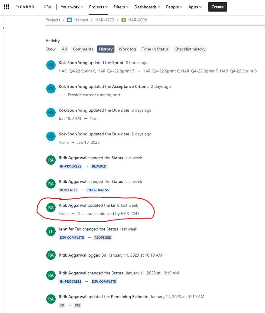

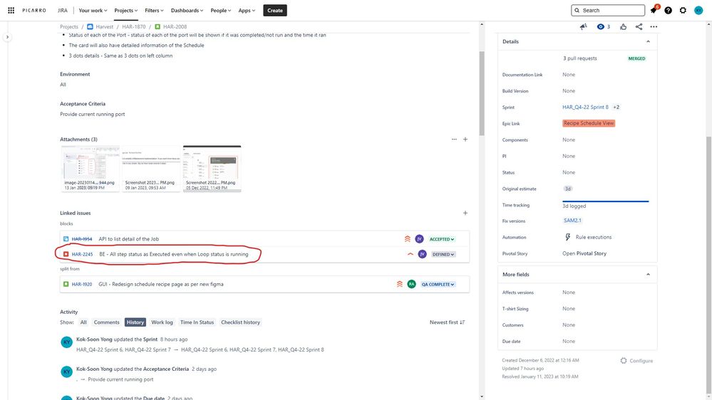

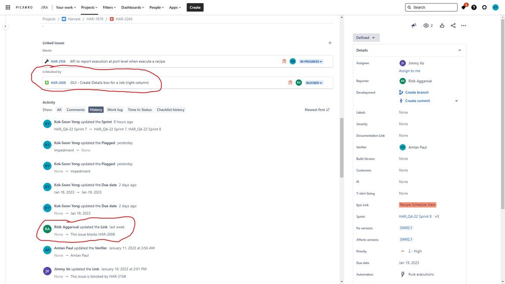

History shows correct blocked relationship.  HAR 2008 is blocked by HAR-2245.
HAR-2008 Linked Issues SectionHAR-2008 History.jpgHAR-2008 Linked Issues.jpgHAR-2245.jpg

Can you look through the older history entries on HAR-2245 and see if you find one for "This issue is blocked by HAR-2008"?
The only way I was able to recreate a situation like this was to (using your Issue IDs in my next statements):
1. In HAR-2008 create a "blocks" link to HAR-2245.
2. In HAR-2008 create an "is blocked by" link to HAR-2245.
(At this point there are two links between the two issues, so that each appears to be blocking the other.)
3. In HAR-2008 delete the link that says HAR-2008 is blocked by HAR-2245.
In the history there is still an entry for when link #2 was created, even though that link no longer exists. And there is no history entry for the removal of that link.
