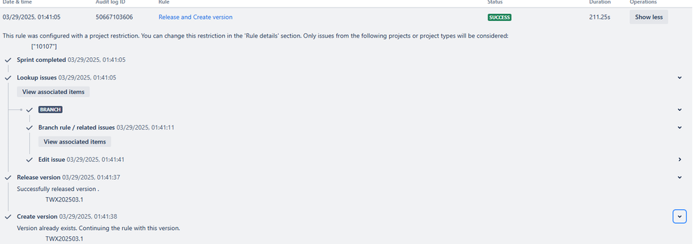

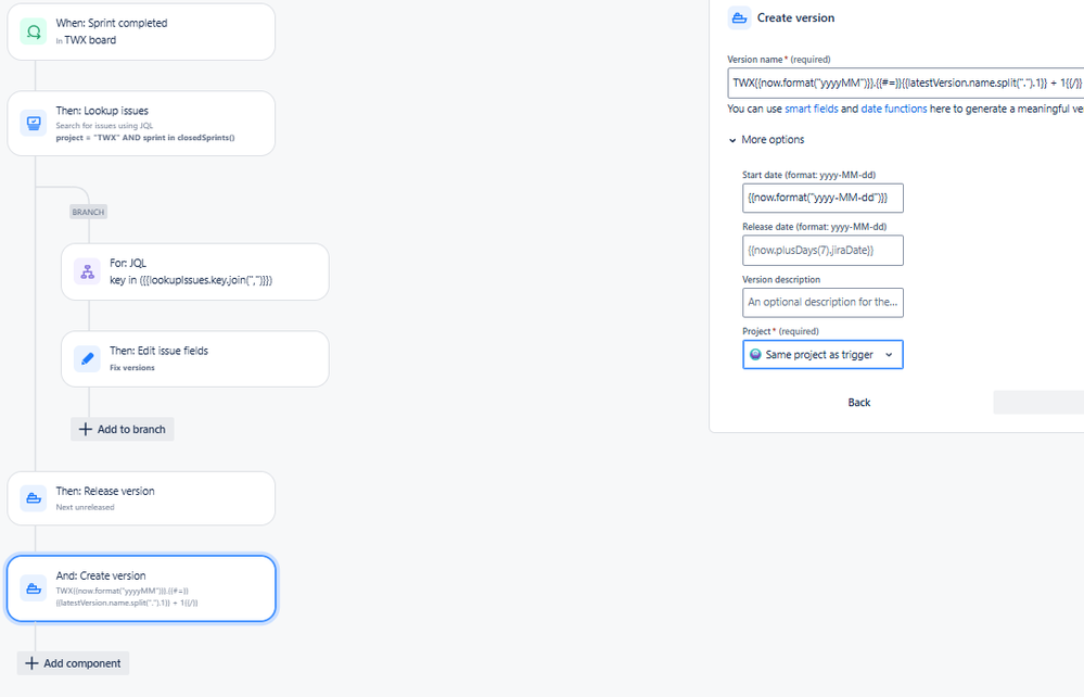

Hi @Bill Sheboy ,
In the audit log, it shows "Version already exists," which is the same version that was recently released.
Variable name: TWX{{now.format("yyyyMM")}}.{{#=}}{{latestVersion.name.split(".").1}} + 1{{/}}

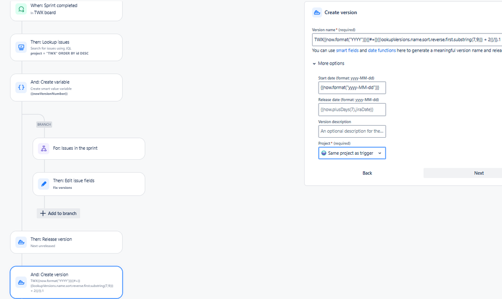

I tried implementing the Create Variable approach by first storing the version name in a variable and then using it to create the version. However, I am still facing the same issue—the version is not being created as expected, and I am getting a different version name.image.png
in this variable name is : TWX{{now.format("YYYY")}}{{#=}}{{lookupVersions.name.sort.reverse.first.substring(7,9)}} + 2{{/}}.1
Smart value: TWX{{now.format("YYYY")}}{{#=}}{{lookupVersions.name.sort.reverse.first.substring(7,9)}} + 2{{/}}.1

There is no smart value named {{latestVersion}}.  What are you expecting that value to contain?
What value is set to the Fix Versions field in the Edit Issue action?
And most importantly...your rule trigger is Sprint Completed.  Why not use {{sprint.id}} with the branch JQL to find the issues in the sprint?  The Lookup Issues action does not appear to be needed...and could return the incorrect issues than you expect: it will return ALL of the issues in completed sprints (or at least the first 100 of them).

The list functions you show do not exist: sort and reverse.  When one wants to order the results of the Lookup Issues action, an ORDER BY clause is added to the JQL.
But that will not help for this scenario because it cannot sort a list-of-lists (i.e., Fix Versions is a list within the lookup issues result, which is also a list)
There is no smart value named {{lookupVersions}}

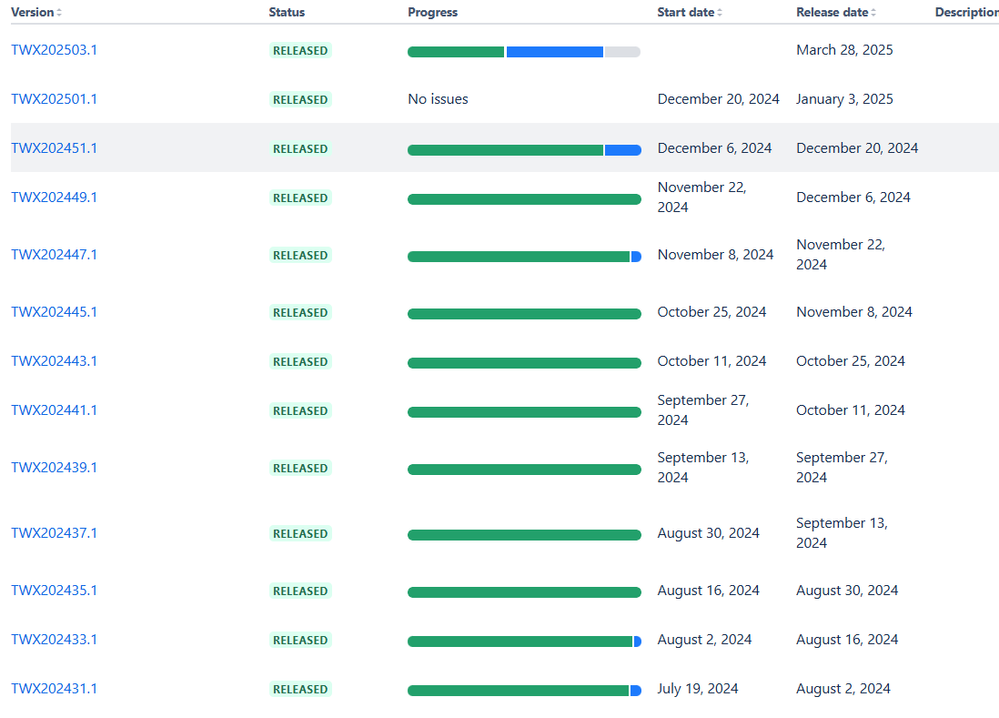

I want to create an automation rule that releases the current version and then creates a new release version when the sprint is closed. I also plan to extend this rule to add the release notes to a Confluence page.
In each sprint, there is only one Fix Version available.
The version number should follow a structured pattern.
I will share a picture of previous release versions to clarify the expected naming sequence.image.png
The version name format should follow this pattern: Current version: TWX202503.1 Next version: TWX202505.1 Following versions: TWX202507.1, TWX202509.1, … TWX202601.1, etc.

Thanks for that additional information.  Please answer these questions:
How is the Fix Version field changing for the work item in the Sprint when the rule runs?
What should the rule do if there are multiple different versions assigned to the Sprint's work items, perhaps due to an entry error?

Thanks for your response! The Fix Version is assigned only to issues in the Review and Done states. When the Sprint closes, only these issues are moved to the current release version.
Since only one version is assigned per Sprint in my project, there’s no concern about handling multiple versions due to entry errors. That simplifies the process.
For now, we can skip the Fix Version assignment since I’ll handle it later.
The main focus remains on ensuring the correct version naming convention when creating the next version refine the logic to generate the proper sequence based on the Sprint completion schedule.

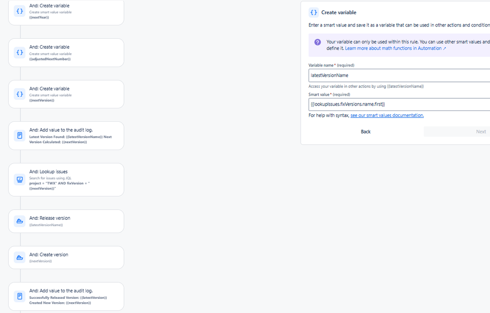

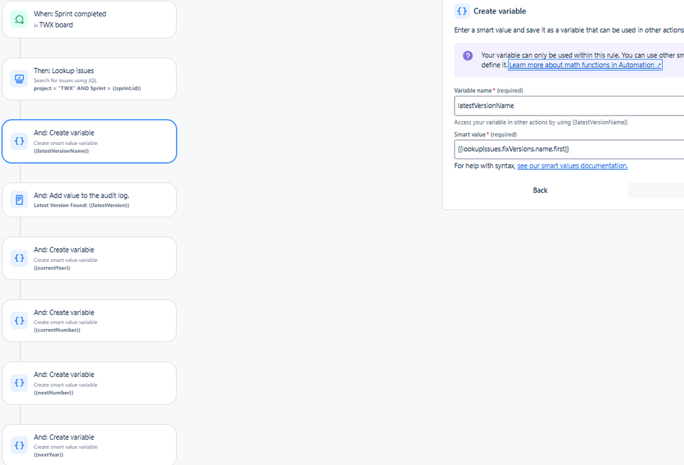

I tried to implement the rule, but I'm facing issues with creating the version name unable to create correct variable. I am sharing the implemented rule and audit log. Please help me resolve this. image.png
after lookup issue
create variable: latestVersionName
              value: {{lookupIssues.fixVersions.name.first}}
create variable: currentYear
               value: {{latestVersionName.substring(3,7)}}
create variable: currentNumber
              value: {{latestVersionName.substring(7,9)}}
create variable: nextNumber
              value: {{#=}}{{currentNumber.asNumber}} + 2{{/}}
create variable: nextYear
              value: {{#if(nextNumber > 11)}}{{#=}}{{currentYear.asNumber}} + 1{{/}}{{/}}                                    {{#if(not(nextNumber > 11))}}{{currentYear}}{{/}}
create variable: adjustedNextNumber
              value: {{#if(nextNumber > 11)}}01{{/}} {{#if(not(nextNumber > 11))}}                                              {{nextNumber.padLeft(2, "0")}}{{/}}
create variable: nextVersion
              value: TWX{{nextYear}}{{adjustedNextNumber}}.1
log action: Latest Version Found: {{latestVersionName}} Next Version Calculated: {{nextVersion}}
lookup issue: project = "TWX" AND fixVersion = "{{nextVersion}}"
release version: {{latestVersionName}}
create version: {{nextVersion}}
log action: Successfully Released Version: {{latestVersion}} Created New Version: {{nextVersion}}
audit log:
Sprint completed03/30/2025, 00:54:04
Lookup issues03/30/2025, 00:54:04
Expand
Create variable03/30/2025, 00:54:04
Log action03/30/2025, 00:54:04
Collapse
Log
Create variable03/30/2025, 00:54:05
Log action03/30/2025, 00:54:05
Collapse
Log
Latest Version Found: Next Version Calculated: TWX .1
Lookup issues03/30/2025, 00:54:05
Collapse
Unable to run the search while custom values were being defined: .
Custom Smart Value JQL Search: "(project = "TWX" AND fixVersion = "TWX .1") AND (project in (10107))" - The value 'TWX .1' does not exist for the field 'fixVersion'.
Release version03/30/2025, 00:54:05
Expand
Create version03/30/2025, 00:54:06
Expand
Log action03/30/2025, 00:54:06
Collapse
Log
Successfully Released Version: Created New Version: TWX .1

Thank you for the additional details as they help identify where the problems exist.  Here are some suggestions:
  • The variable named latestVersionName should use this value for the first Fix Version in the first issue found from the lookup.  Note this is a list-of-lists and so both first functions are needed.
{{lookupIssues.first.fixVersions.first.name}}
  • In several places, the writes to the audit log do not match the created variable names, and so they write as empty.  For example, change {{latestVersion}} to {{latestVersionName}}
  • Your conditional logic does not use the correct syntax: it cannot be mixed with the math expression conditions.  You could use the longer form of the if() function to help as that has true and false return values.  Note this format of the if() function does not include the pound sign # prefix as it is not using section handling.
Let's try these replacements for some of your variables:
  • action: create variable
    • name: nextNumber
    • value: {{currentNumber.asNumber.plus(2)}}
    • name: nextYear
    • value: {{if(nextNumber.asNumber.gt(11), currentYear.asNumber.plus(1), currentYear)}}
    • name: adjustedNextNumber
    • value: {{if(nextNumber.asNumber.gt(11), "01", nextNumber.leftPad(2, "0"))}}

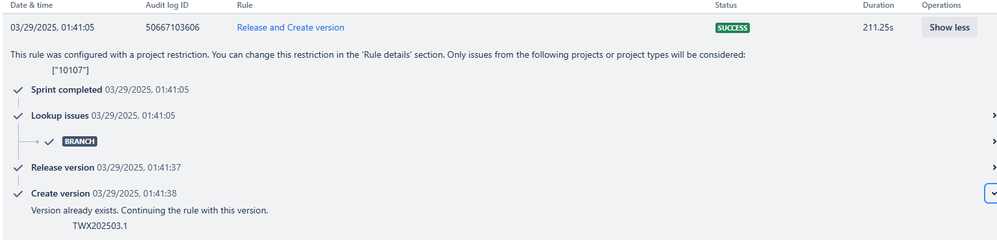

@Sundram Trivedi can you share with us the full expression for version name? what is the output when you run the automation?
Sundram Trivedi
March 28, 2025
Hi @Sayed Bares _ServiceRocket_
This is the audit log:
Variable name: TWX{{now.format("yyyyMM")}}.{{#=}}{{latestVersion.name.split(".").1}} + 1{{/}}image.png
